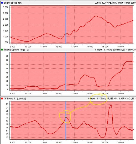

you have AFR 15-18 under load.
MAF, fuel pressure - check

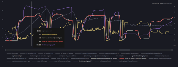

I put the old MAF on for testing, but there was no difference in this jerking. Below is the LOG with the new MAF, Lambda under load is around 0.9
