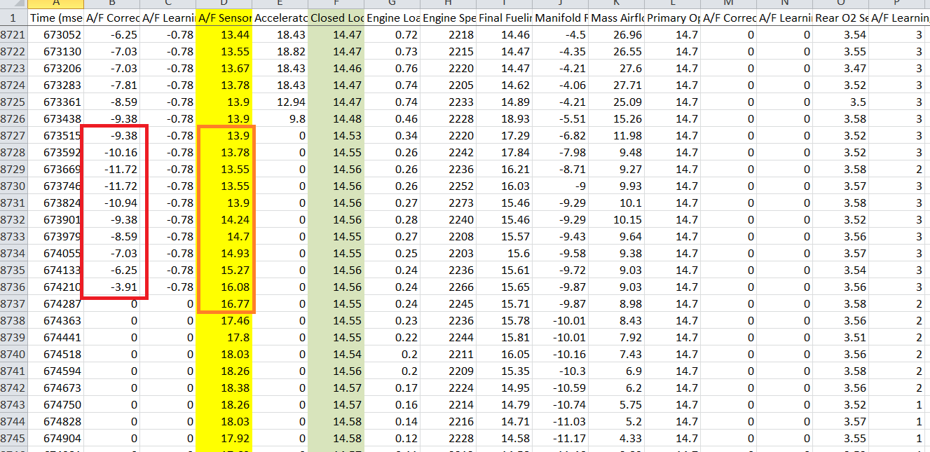

It does look quite lean in places, but looks like the ECU is pulling fuel there making it lean??
have I screwed up my injector settings? ID1050-XDS
The Low pulse widths ok? - they high negatives (copied their settings for Cobb)
Attached the log as well, currently stock MAF intake with K/N Panel (and perrin silicone Turbo inlet), got a 3d printed MAF to fit and scale from stock MAF later, but want to get this issue sorted before that, so I'm not chasing my tail.
I'll re-insate the 1018.47 for Injector flow, and see how that goes (0% ethanol here), ( I only pulled it back to 1064.5 due to fuel being pulled everywhere.)

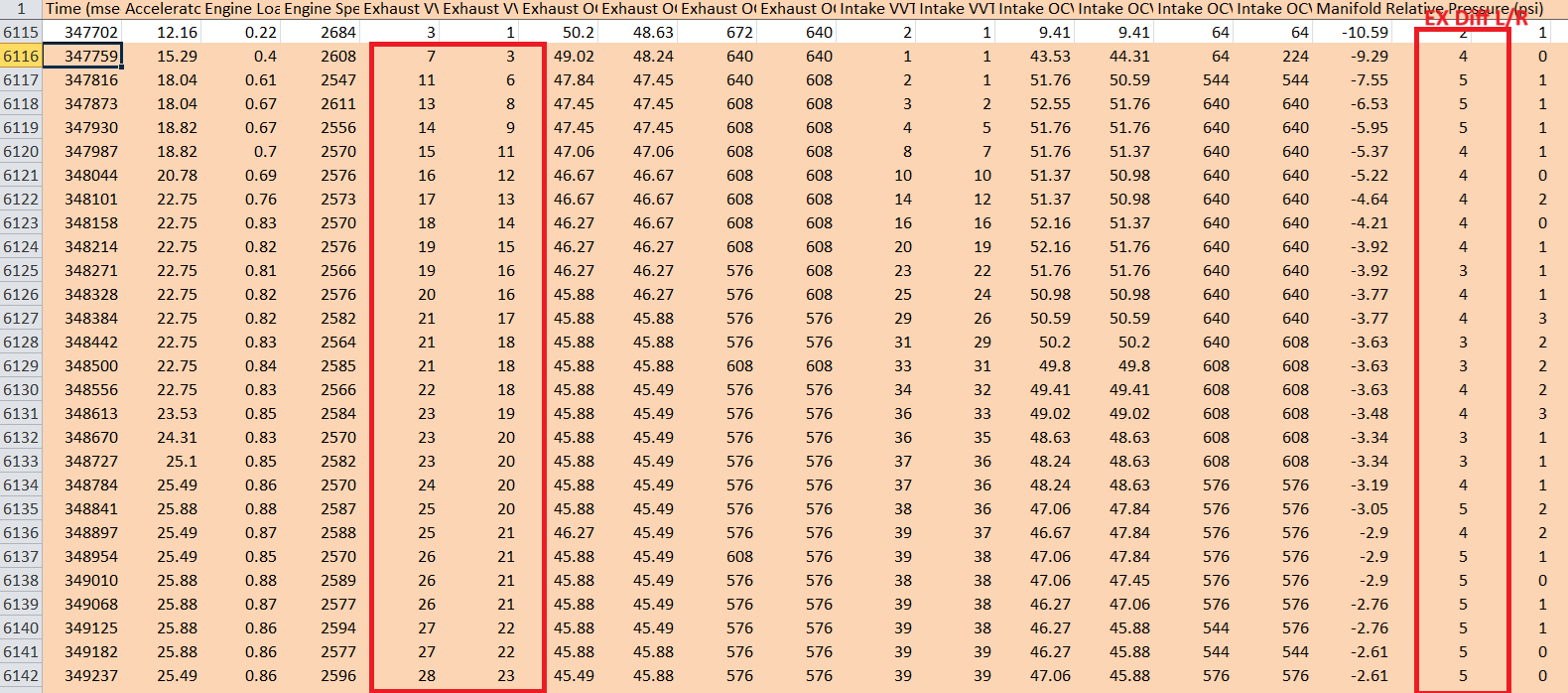

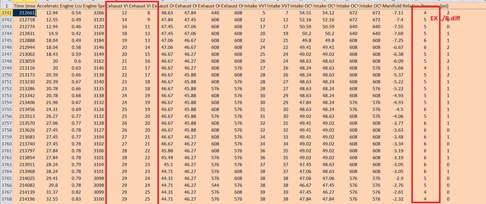

I did some WOT runs as well (attached), they seem ok, but there are some point where exhaust is up to 5 or 6 deg difference, is this ok?
a couple of examples
Offset 212661
And Offset 347759

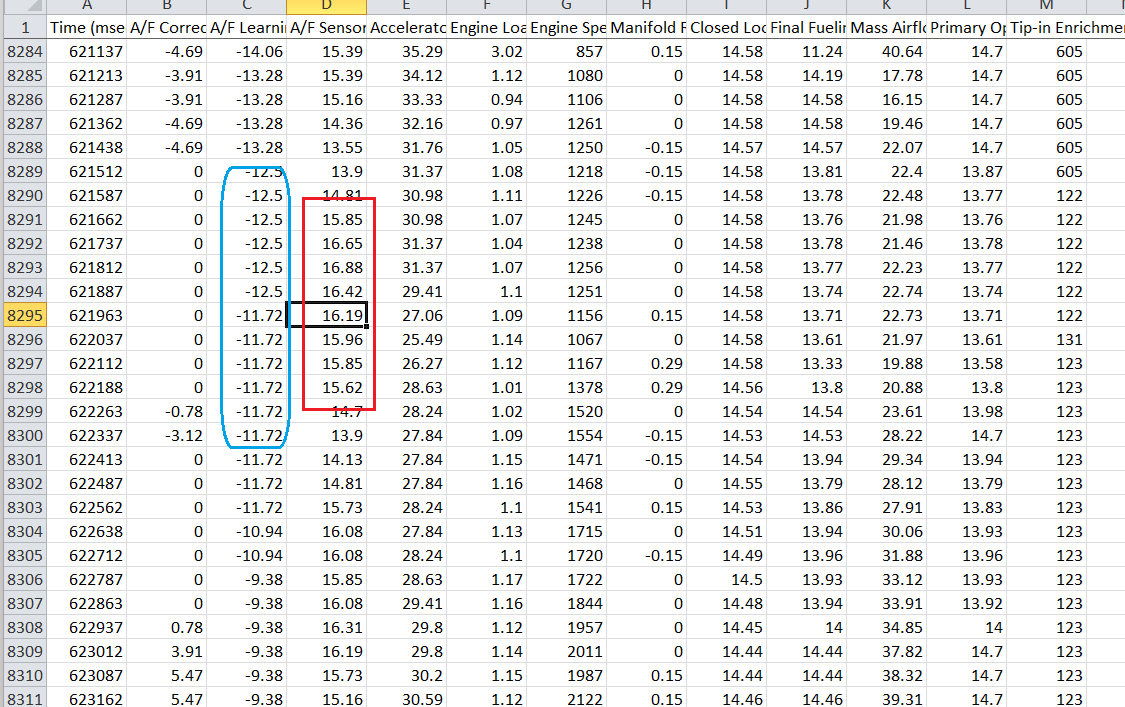

I'm wondering if its my O2 being slow to respond causing the closed loop to get a bit wonkey?
another log with fuel scale back at 1018.47 (4.9% ish more fuel), as usual its seems fine until I've done a few KM then starts doing this issue.
Is this normal, or slow to respond (I do have an aftermarket 3" downpipe, and the O2 sensor is OEM and only 6 months old), if this is not normal (response speed) then either a bad O2 or where it is positioned in the down pipe is a bad spot (being twin scroll the O2 is in down pipe not the manifold), maybe its not sitting in the turbine stream, being a open end 3 inch pipe (could be off the the side a bit - not seeing direct exahust stream), maybe I'm grasping as straws as well lol...
Here - getting on the throttle - it slow to go richer, then a slight overshoot in correction then back
There here, after lift right off throttle - slow going lean - (you can see the self learn trying to pull heaps out - perhaps its dominating the longer term learning)
I've got nothing to compare it to, so is that slowness normal?, if not, it would make sense its this causing it
