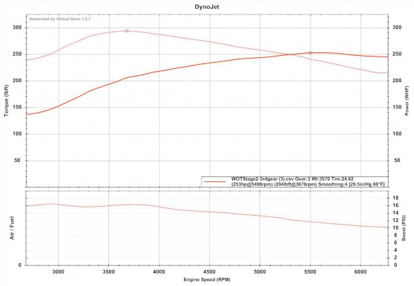

2006 Subaru Impreza WRX MT USDM - Stage 2 Tune (A8DH201X)
Features
Minimized Turbo Lag
Peak Boost of ~16.8 PSI @2800 RPM
Peak engine load of 3.0 g/rev @3600 RPM
Revised AVCS for less EGR and better performance
Revised Ignition timing for knock-free power
Open Loop fueling tuned for power & reliability (EGT, Knock Control)
Open Loop delay disabled
Throttle tuning for a more linear yet sharper response
Comments
It makes great midrange torque and the car feels very 'sharp'. Full boost response is about 300-500 RPM above WOT point which is very quick. Let me know of any issues. You can find my contact info on my website http://www.picklertune.com
This map was tested with a highflow catted downpipe and a 3" catback.
Road Dyno:
File comment: 91 octane road-dyno

PostPosted: Sat Jul 18, 2015 5:28 pm
Stage 2, but what modifications are necessary for this? High flow cat or catless, ect.
 Post subject: Re: Pickler's '06 WRX Stage 2
PostPosted: Sat Jul 18, 2015 5:36 pm
Joined: Wed Jul 04, 2012 2:05 pm
Posts: 377

So I gave this map a shot and did a few logs. I am always using my car at over 5000ft altitude and the air density is typically above that. My wastegate duty cycle ramped up to 80+ percent to even hold 15lbs. I am using 91oct in New Mexico and knock was there just not high enough for the ecu to pull a lot of timing. In fact in my log the ecu was adding timing in the upper rpm, high load areas. "2.31"ish at 100% throttle. after 3200rpm. Main reason I am writing this is because I wanted to see who was still watching. I also like to hear others experiances with their 06. I used to have an 05 evo and that is were I learned ecuflash and logging with evoscan. Romraider is easy to use and clean as far as glitches goes. I need to get FIC1000's and a larger pump soon just so when I upgrade turbo and engine internals, My fuel system is where I want it. I like raceway and speedway driving and spirited weekend driving. I dont usually commute but I do make the occasional road trip 1200miles west to Northern CA where I have family. Anyone have similar use with their car? I have been looking into fp red, journal bearing, and the blouch td05 or whatever will get me just over 400 to the wheels at 5k altitude and let me drive it home.

how does these tunes compare to bullwinkles? i have been learning off bullwinkles and the fueling strategy differences are interesting. why are the fueling for the 93 tbe tunes so different?
which tune is a better base to tune off of?
oh man more questions come to mind as i write this. bull winkle targets like 18psi while pickler only 16.7. load cells scalled way higher on bull winkle and stay rather stock on picklers. pickler also has no avcs at the top?
the timing is also vastly different.
ive been tuning now for about a year learning off romraider and youtube.
my car is a 2006 subaru forester xt, 5 speed.
mods: perrin v1 downpipe (with cat and wideband), 3" turbo back, TD04 turbo, stage 2 clutch, ppe (built trans) gears,
AOS, cyl 4 coolant mod.
STOCK INTERCOOLER.
engine is healthy.
my goal is quick spool and max torque. these turbos make nothign up top so i just want to maximize what i can get out of this turbo in the midrange it works best in.
