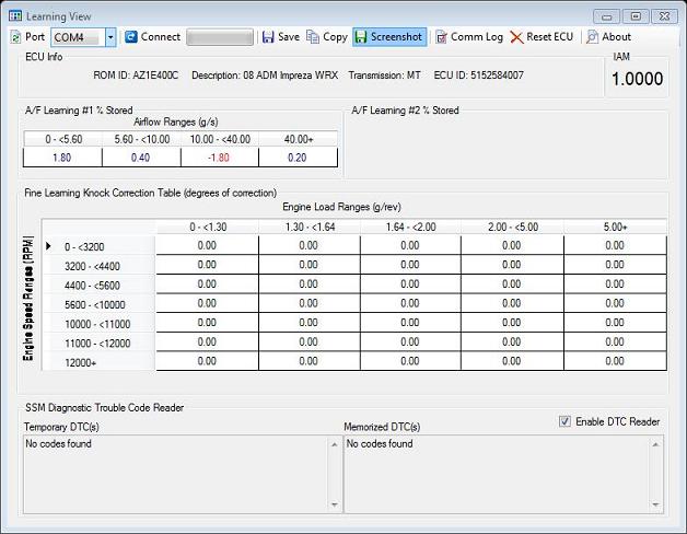

here is new map no work done to range under 2000 rpm i left it stock also higher rpms are stockish, i have only adjusted boost and Associated WGDC tables, also made a few minor changes to fueling to compensate for more boost. Also few minor tweaks to Turbo dynamics and boost limits etc.
I have driven a lot making minor tweaks to the maps as i logged and drove. I made sure this is 100% safe on my car, i hardly ever get any knock, its the same amount as running stock tune and hardly ever at high loads/rpm. (like stock rom)
here is the rom and a learning view after a long drive 2 hours in traffic, will post a log of this new revision as soon as i can.
Also i made this rom on a ADM MY08 WRX using 98RON fuel (Vpower). On a everything stock car.

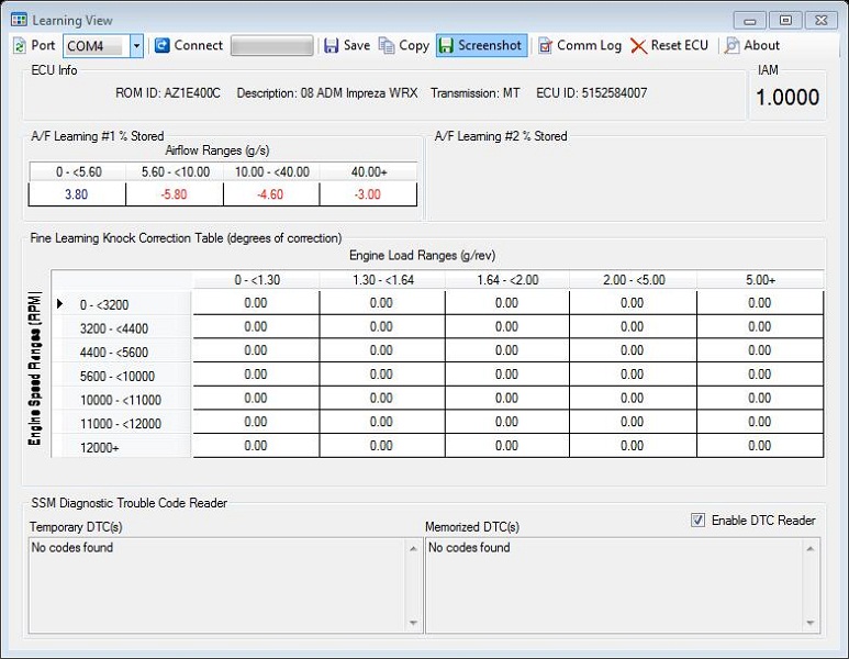

Here is a Map i have run for about 1 month now, it runs very good. (ADM 2008 WRX)
All i have changed on the car is i added a K&N panel air filter. But you don't need it, i was running this tune on the stock air filter fine.
File comment: Leaning View Screen shot after 1 month
There are some very minor boost spikes around 2.5K RPM but everything else is fine. I'm working on the next version at the moment and have fixed this by better WGDC's and have now added more boost.
