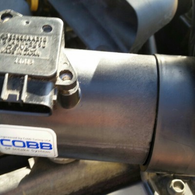

I wonder if the Cobb SF intake include a wider MAF housing, which would explain the richer MAF scaling figures? I just installed the SF intake on a 08 STi, stock rom & experienced a constant slight hesitation just before hitting positive boost. I tempted to try the scaling figures published earlier hoping it would fix the issue.

Not sure about you guys but that 30% increase in MAF scaling is optimistic considering the size differences
I was told the SF in the name stands for same flow.
