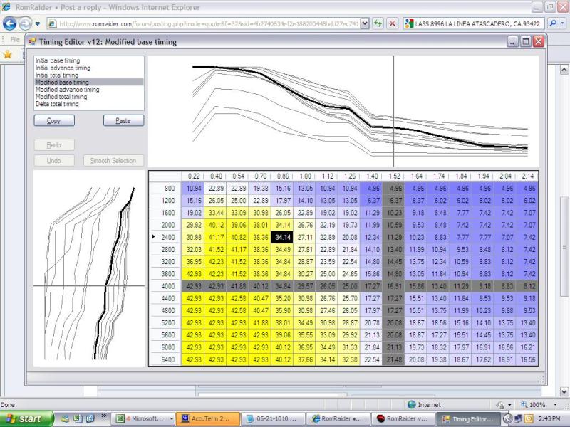

How to use:
* Select "initial base timing"
* Paste your base timing table from RomRaider
* Select "initial advance timing"
* Paste your timing advance table from RomRaider
* Select "initial total timing"
* Move the mouse over the cells in the table, and watch.
* Select the "Modified Xxxx" stuff, and notice the help text at the bottom of the window.
* Make changes. Note that the "total timing" views can be inaccurate if your base and advance tables have different row and column headers.
* Copy the modified base/advance tables and paste them into RomRaider.
* Double-check everything in RomRaider.
* Flash, log, repeat.
FOr INitial Base TIming, I got my base timing table.
For Initial Advance timing, i got the Knock Correction Advance Max
What am I watching for and when do i use the smoothing tool (if needed).
My tables are sized differently, so what has to be done?
 Post subject: Re: UTILITY: Timing Editor (v12, 2009/12/29)
PostPosted: Sat May 22, 2010 3:29 am
suebaroo wrote:
Where do I fidn the Inital advance timing?
That's "Initial" as in initial-vs-modified. Maybe I should call it before and after?
You copy the base timing and advance timing tables from RomRaider and paste them into the initial base and initial advance tables in the editor. Then you party on the modified base and modified advance tables in the editor.
You can toggle between the initial and modified tables to see how your changes compare to what you started with. When you're satisifed, paste the modified tables into RomRaider.
