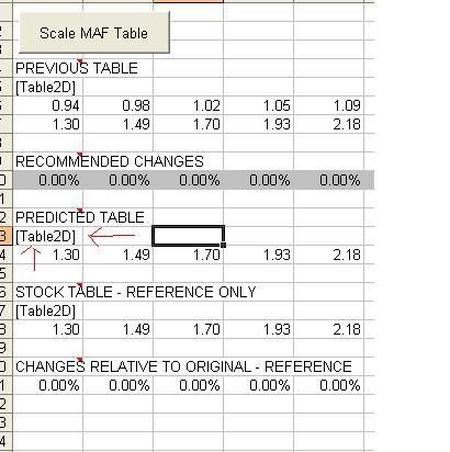

Am I correct that on the last tab, MAF Table, the percentages in Row 10 would apply to any MAF calibration that you have downloaded into the ECU, even if the values in the spread sheet are ones that mickey placed there?
In other words: If I subtract or add the percentage to each site that needs adjustment, it doesn't matter what the MAF values that are written in Previous Table Row 7? I can just multiple times 1.073 or .947 or a 7.3% change up or down.
BTW thank you very much for the sheet, it's very useful.
PostPosted: Mon Aug 13, 2007 3:09 pm
Row 6 is the MAF(v) from the MAF table that was used for the datalogs.
Row 7 is the MAF(g/s) from the MAF table that was used for the datalogs.
Row 10 is the desired changes in percentage that you want to apply to Row 7. The cells with the white background are derived from the charts. The cells with the grey background are values that the macro did not change and entered in 0%. You can manually modify any value in Row 10 after you use the macro.
Row 14 becomes the new MAF(g/s). You can cut and paste this into RomRaider.
Row 16 to Row 21 are for reference only.

Joined: Mon Sep 18, 2006 10:55 am
Posts: 229
Hey,
Shouldn't it say [Selection1D] below PREDICTED TABLE so that when you only copy "Airflow g/s" you can just paste it right in RomRaider?
