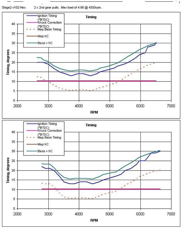

absolutely loving the spreadsheet, Airboy! Here's a few graphs i made the other day. :D :D
2nd gear pulls

So (using the chart above as reference) is the idea to get the green line to match up to the blue line?
When the ecu is "happy", the two lines should overlay. The offset that is in the above graphs could be from the Knock Learning table, which takes time to populate after a re-flash/reset.
