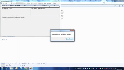

Hello,
I'm new to all this but I've read through the entire post and the only thing I can see to try is to move the Learning View Folder to the desktop. I will do that when I get my car back later. In summary:
    I’ve got Microsoft .net Framework 4 installed
    Tactrix 2.0 (I know it works as I log using RomRaider)
    All other software off
    Car to On (but not with engine running)
    ECU supported (see error log for details)
I then tried v0.6 and got the ”ECU not currently supported” error.
Have I not seen a fix, being a noob muppet? :D
Many thanks,
Scott
LearningView_LOG 0.6 error.txt [1.56 KiB]

For whatever reason your ECU failed to respond to the command to retrieve the FLKC load values. This is a command that settings a start address and asks the ECU to send back X number of bytes from the start address. Yours did not respond which is odd.
Try this:
  • open the RomRaider EcuEditor
  • under the SSM menu Launch Test App
  • with the command set to Init press Send, you should get a ECU init sequence of bytes. If not the ECU did not respond (figure out why and fix until this step is successful)
  • set command to Read
  • set Address to 0CDF68 (the first digit is a zero)
  • set Read length to 16
  • press Send command
Can you provide the response from the Trace window? (Ctrl-a to select all, Ctrl-c to copy the response)

 Post subject: Re: Learning View v1.0 RC3
PostPosted: Sun Aug 25, 2013 6:26 am
Joined: Wed Jul 10, 2013 8:57 am
Posts: 11
Try this:
Hello,
Please forgive the tardy response: holiday, kids and painting the house to pacify the wife, have kept me otherwise occupied :(
Please find below the output as requested:
SND [Read]: 8010F006A0000CDF680F88
RCV [Read]: 80F01011E03FA666663FD1EB854000000040A00000C2
DATA [Raw]: 3FA666663FD1EB854000000040A00000
Many thanks,
Scott

Well it didn't have a problem reading that time.
The result is 1.3, 1.64, 2.0, 5.0
The latest RomRaider also has Learning Tables View now. You could try it if you continue to have trouble.

Hi Scott. In the two previous Learning View logs you posted (one from version 0.6 and one from version 1.0), it fails to get a response from the ECU for the IAM in one and FLKC load axis in the other. So it appears that it is an intermittent comms issue. I would download the latest version of Ecuflash and re-install (also update the Openport 2.0 firmware via Ecuflash if a new one is available) and then give it a go in Learning View again. If you still have problems, post up the logs and also try logging in RomRaider with the Openport 2.0 for an extended period of time (say for a 10 minute drive) and see if the same thing happens.
PostPosted: Thu Sep 26, 2013 6:42 pm
Posts: 11
Well after much un-installing and re-installing of software and drivers I finally found the reason. The USB ports on the left side of my laptop are 3.0 and that was what I have been using as that side is nearest the OBD-II socket. When, for some reason, I used the right side (which only has USB 2.0) it worked!
Cheers for all your help. All the best,
Scott
