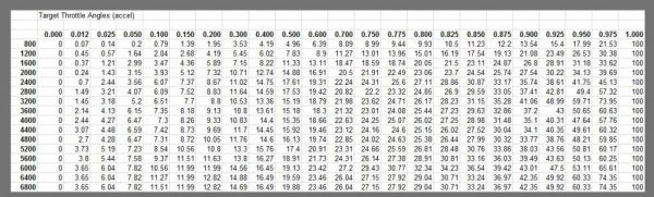

I have a 2013 STI, and I have this table, which seems different then what you currently have set-up in your DBW graphs on the log-file-inter sheet.
Any chance it is being modded in the future, or am I missing something?

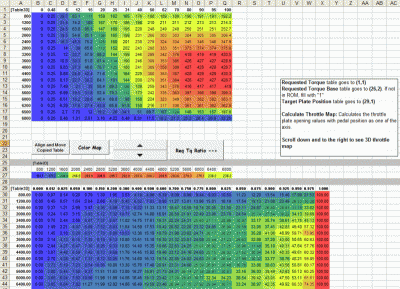

The throttle page works with the "new" tables that uses Requested Torque Base (2D table with RPM axis). Should look something like this:

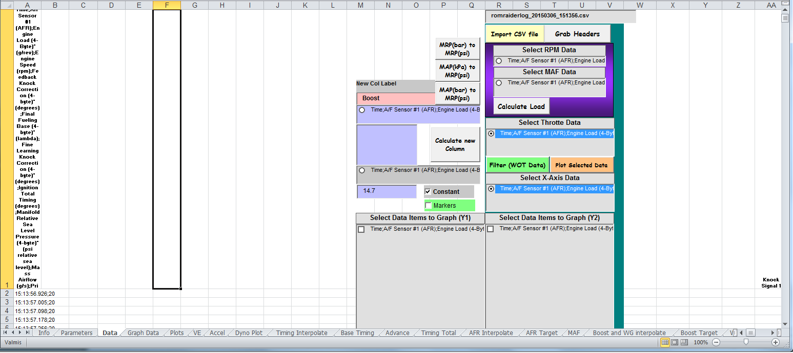

I tryed to my friend Office Excel 2010 and not work with that. Any info / tutorial how that excel use, i only import that RR csv file to program and thats not work. I attached that csv file and screenshot that excel view this message. Hope someone can help, if that not work i dont get that office 2010 :)
File comment: RR log.csv
romraiderlog_20150306_151356.csv [12.72 KiB]
Downloaded 587 times
File comment: Screenshot
The regional settings is part of the problem. The numbers in the log files doesn't use "." for the decimal point and the separator is not ",' so the macros can't parse the file properly.
