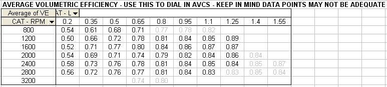

I look at the VE sheet and have a question here.
How to check and dial in the calculated table in the AVCS?
Q1 : Does it just dial in the value as degree plus?
I saw some column is indicated grey.
Q2 : Does it mean dial in the value as degree minus?
 Post subject: Re: Spreadsheet to track Knock and VE
PostPosted: Tue Aug 05, 2008 7:59 pm
For AVCS tuning in the WOT cells, I use acceleration (dyno plot) comparisons.
For AVCS tuning, Freon had recommended using the VEm data. I added it to the spreadsheet because it was easy but I haven't really used it. Tuning AVCS takes a long time and a lot of data.
The greyed out cells means there isn't enough data.

How do you use the Average Volumetric Efficiency table to alter your AVCS?...I'm totally lost here! :oops:
PostPosted: Thu Dec 11, 2008 8:09 pm
It's supposed to be used for partial throttle tuning.
Adjust AVCS to increase VE.
I just leave my partial throttle AVCS stock except that I remove the auto-EGR portion.

What do the numbers on the table represent?
Remove the auto-EGR portion???...no idea what you referring to...sorry dude!
