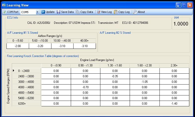

just tried this.. i didnt see anyone else with numbers as high (or low) as -15 in the a/f learning area.. is this bad? or does that mean its just removing more fuel to reach stoich. tuned by clark turner.
 Post subject: Re: Learning View tool
PostPosted: Mon Mar 03, 2008 6:22 am
Joined: Tue Jul 24, 2007 10:28 pm
Posts: 349
Those are BIG corrections. You're removing a lot of fuel to reach stoich. You probably should correct that.
