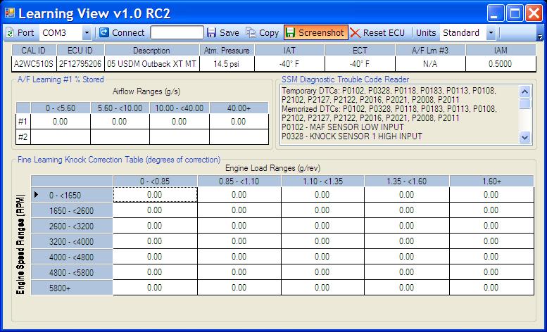

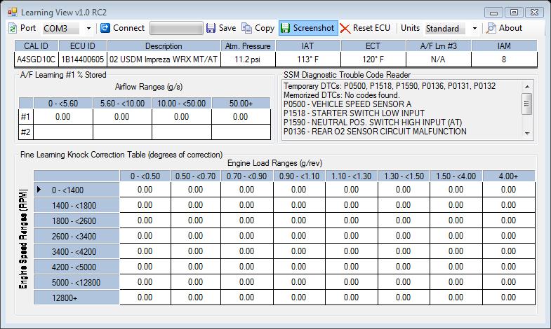

Im confirming that it works with Forester xt 09 EDM AZ1G101N
Here's my screenshot, looking good too. 8) Thanks for this update Merchgod!

Works here, even the DTC portion.
One suggestion, the saved file name format of YYYY-MM-DD would provide better file name sorting as it would allow common years, then months and day sorting. The current format of MM-DD-YYYY would result in the same month of multiple years to be intermingled.
Thanks for provide this update.

02rexwi wrote:
Is the group N SD ROM supported in this release?
Yes, it is. Please try it out as I had to add a special case for this ECU to display the a/f axis as MAP instead of airflow, so I'm wondering if it worked properly.
Bill
 Post subject: Re: Learning View v1.0 RC2
PostPosted: Wed Jul 06, 2011 3:19 am
Good point! I'll change this in the next release candidate.
PostPosted: Wed Jul 06, 2011 3:20 am
Wait...are all those DTCs you have listed there accurate?
