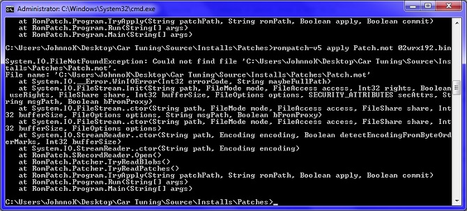

here's my error....
is this EXE just a long batch command? What does it actually do to "patch" the rom, extend memory allocations?
File comment: screnshot
