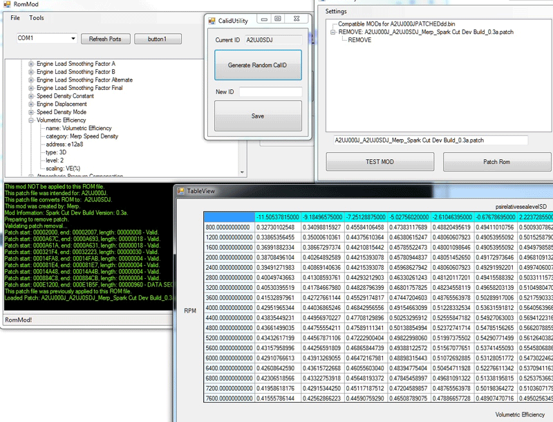

^^ All of the above is complete. Will be uploading the command line utility to my git after a few more rounds of debug testing :)
And here's a little teaser:
Please do not send me support questions via PM, use the forum instead!
