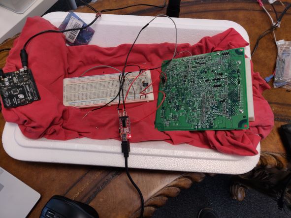

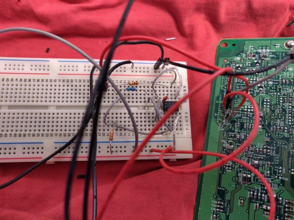

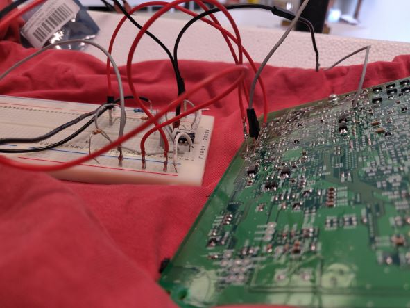

HI guys,,,
well, i have been trying for about a week now to get this thing to recover my ecu... but still no dice..... IDK what to do at this point...
I cant even get the FT232 to be reconized by the usb connection... im starting to think maybe its no good...
Here are some crapy pics of my setup... maybe someone notices something im doing wrong...
if anyone is willing to recover this ecu for me or help me figure out what im doing wrong, id gladdy compinsate you for your time...

Ecu I'd?

Posts: 278
ft232 must be visible as "usb to com port" in device list. If not, you can't use it.
 Post subject: Re: SH Boot Mode How-to
PostPosted: Wed Mar 16, 2022 9:08 am
Verify VID\PID of unknown USB device.
If you see PID=0000 you have got a fake FT232 chip.

How are you powering the ECU?

ok, So now i have got a little further...
But first - MY ecu is a A2Zje11j / sh7058
Now - am i correct in thinking that i DO NOT connect the test plugs?
So i never got the ft232 working, so i used my arduino uno...
now i cant get ecuflash to boot the ecu... i assume thats becuase my uno dont have a FTDI chip...
Using FDT unsupported version in simple mode, and with the ecu in the car, i can get it to respond (im pretty sure) But if i turn the key on to power the ecu, it wont connect.. if i leave the key off, it trys.....- and once it even did the first erase i believe.. ill post the log below...
Clock Frequency (External) = 10.0000MHz, Clock Mode = 0, CKM = 4, and CKP = 2
Connecting to device 'SH/7058F' on 'COM5'
powerd 5v from the arduino uno..
PostPosted: Thu Mar 17, 2022 3:51 pm
Posts: 278
lordofthegeeks wrote:
That's a mistake... you need to power your ecu normally from 12v power source. BAT, IGN, ACC, GND, something like that.
Or place it back to car, with ft232 and watchdog lines soldered.

Thats what i have done... its pugged into the car......

Well I'm using the uno as USB to serial converter....
I have the 955 timer which I guess is the replacement for the 555 however from what I've read it seems that I need smaller resistors which I don't have... I purchased the 47.5 k and 1K as per instructions... So that may be the issue... Is there a way to use this Arduino Uno instead is that what you're saying???
