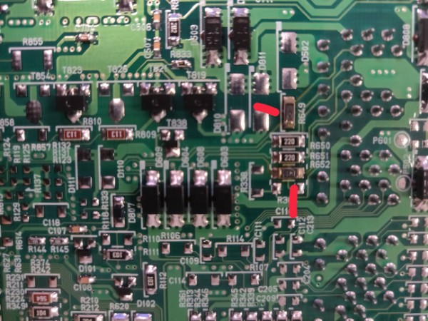

its having missfire on number one and four...
I cant seem to locate any issue... so im left to assume something else is broken on the ecu... I replaced those two resistors on the board and they had contenuity when i finished...
IDK - im at a loss of where to go from here... other than look for another ecu... Unless you guys know of how i can try to locate the problem on this one....
Here is a pic of the two reistors i replaced, they where blown out...
