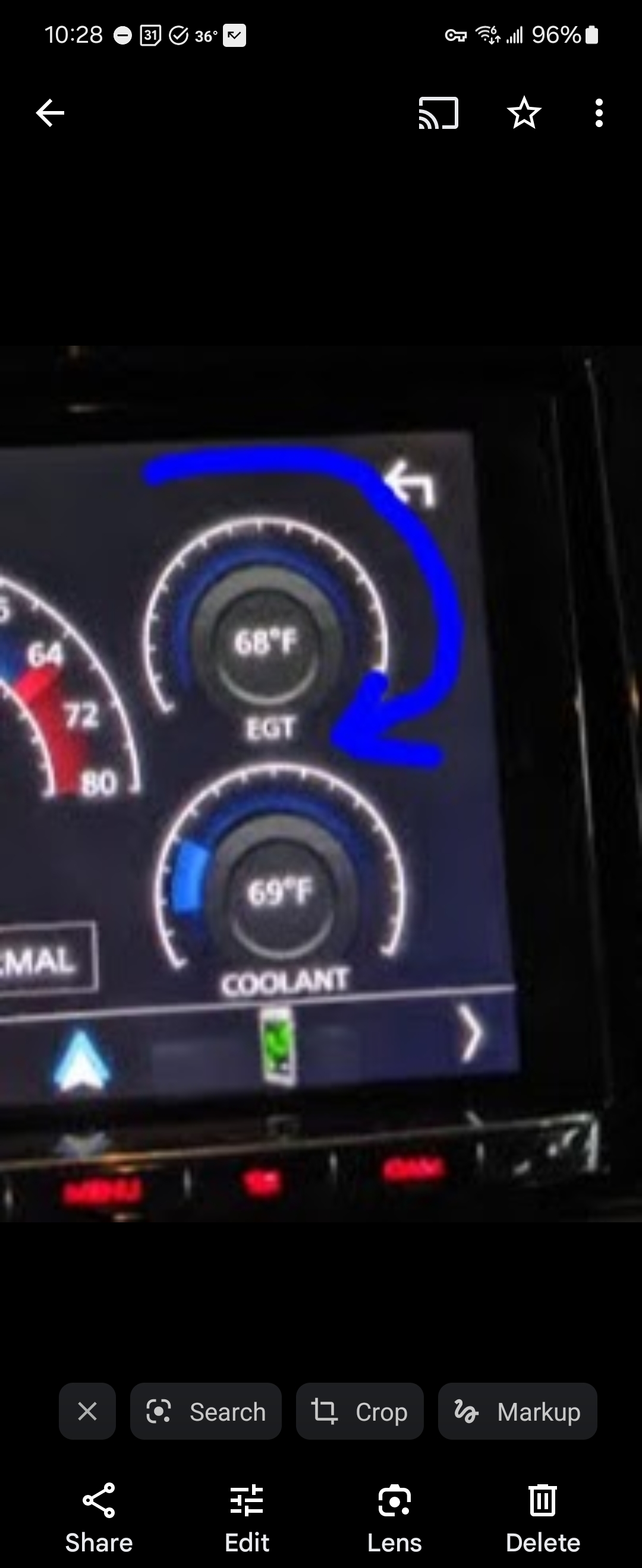

Hi - I've been wanting to convert the front 02 values to display an EGT value.
Does anyone know what the formula may be to come up with the EGT value from the front o2?
I have a Kenwood head unit with Maestro module that taps into CAN and has a gauge pack. The gauge pack has EGT value displayed.
The info they get from the OB2 is - diagnostic coming across diagnostic can lines.
OB2 wires used are 6 and 14 - high speed diag. can lines
3rd tap from Maestro to OB2 is sil data (for TPMS readings).
