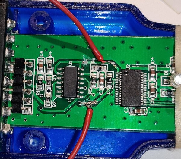

I just noticed while cropping this photo under 1mb that I left flux on the FTDI helper chip and apparently it is conductive..

I understand to connect the pins directly, but it's too dark to solder now. So I connected all the grounds and checked there is 5V on FWE.
I broke the board traces from the FTDI chip to the LM339 and checked they are cut with a ohmmeter. Still no luck. I tried inverting the tx rx again.
It must be my cheap VAGCOM cable. Although it has the correct FTDI chip. Maybe I need to order the DLP232.
I'll try with a 12V battery next.

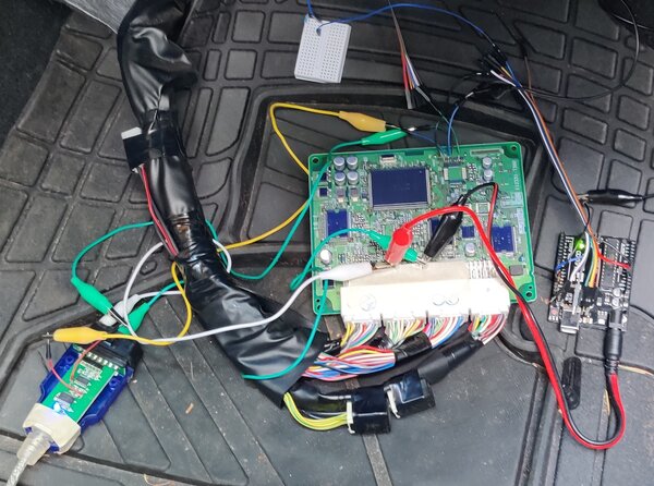

Here is the whole setup. I have 12V power to B135 Backup 19, Control 5&6, B... OH, I see there is Ignition Switch and Ignition Control. I think I need Control not Switch maybe..
Edit: no, I think Ignition Switch was right. Ignition Control shows only 1-3.4V while running.
I'll try plugged into car harness tomorrow, so I don't overpower it again.

Do not use Ignition Control Relay output.
You will overload the control circuit.
Ignition Switch signal may need to be powered .
This PCB does not need Ignition Switch to be powered as far as I remember.
I have seen a lot of fake FT232RL chips. They draw 20-40 ma of 5 V power while the original chip draws almost nothing.
Windows7/Windows8/Windows10 driver disables fakes by setting USB PID to 0000.

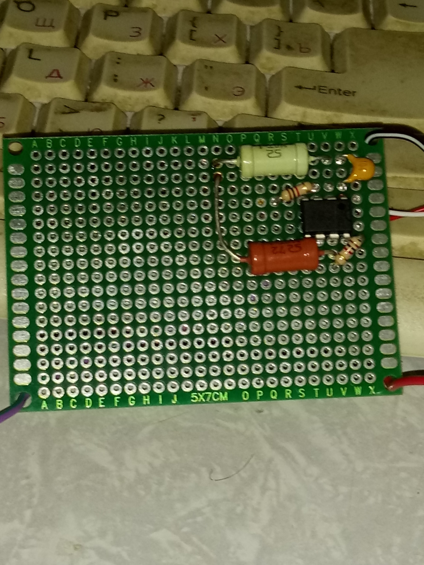

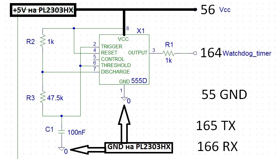

Try to make a watchdog with 555 timer. It's very simple, but 100% working solution.
