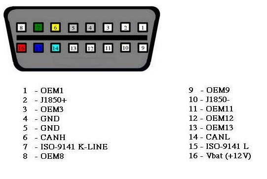

Serg, thanks. I tried connecting on the bench.. I found the correct pinout online, below. Connected CAN+/- to Taxtrix (do I need to invert?). Connected 12V to:

Connect GND(4 or 5) & +12V(16). Pinout for OP2.0:

Looked at you photo, seems you choose wrong pins for CAN lines. Make a photo in front of OP pins.

That was it. It connected. Rookie mistake. Thank you

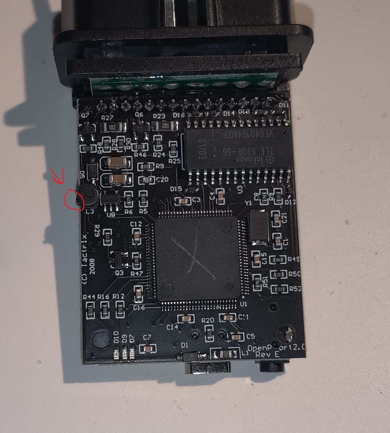

Look on the L3, it lift in the air? Check all elements, quality is really bad...

Yes, I was going to mention that. Thanks. I can check the connections, but I need to get a better DMM multimeter to be able to check.
I found this YouTube also. So I'll check if the 5V power chip is working. If not I have some 12v to 5v chips. https://youtu.be/N4XJSuh10Xs

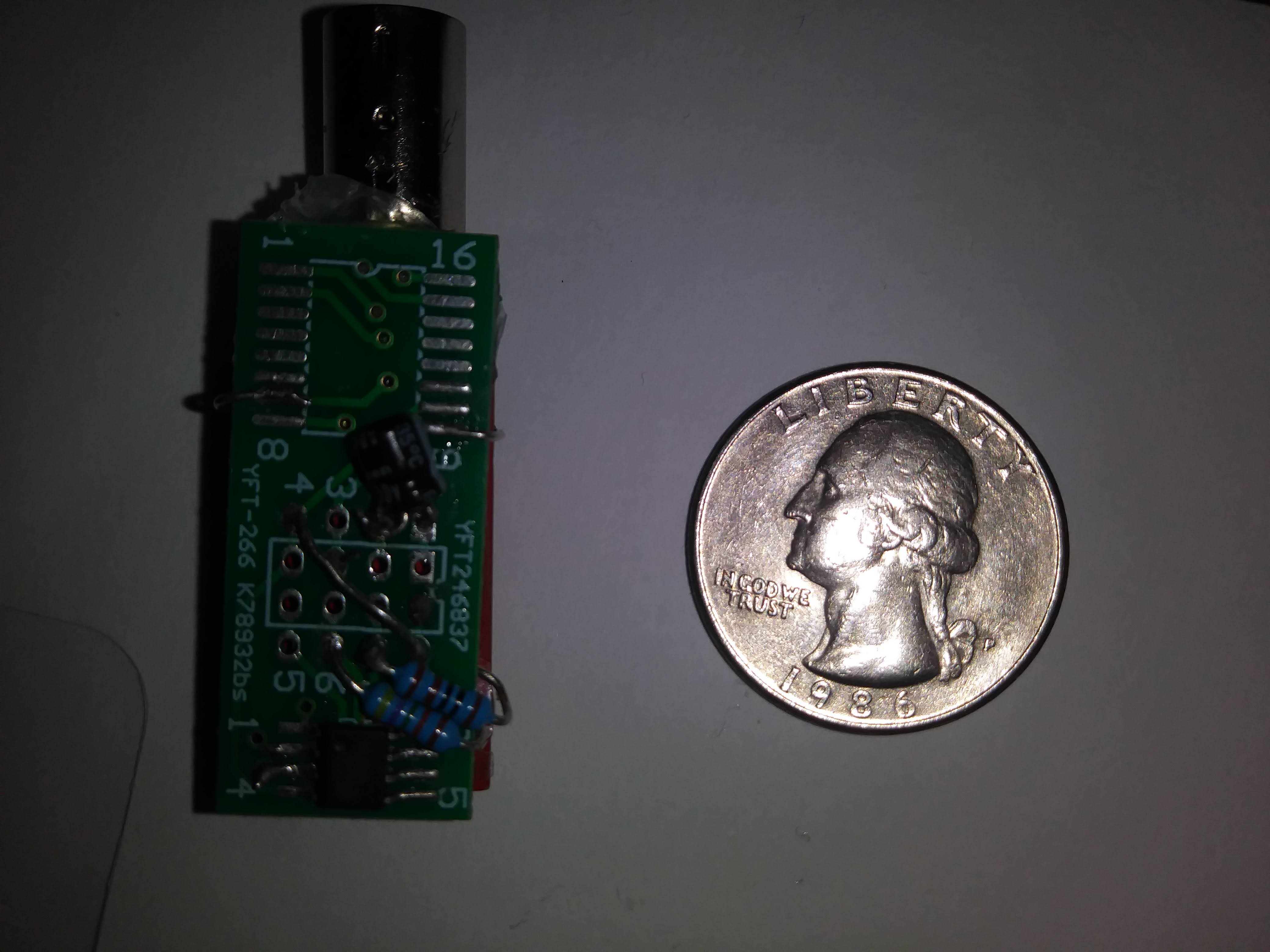

I feel for you aaa. This should be a lesson learned, that when it comes to your car, being cheap is not always the way to go, especially with the bits that make the car run. Especially if it's a daily driver. Anyhow, gotta show off my Boot Board. Tested and verified multiple times.
This cost me a total of 20 US Dollars give or take a few. I did have the green board already from a kit I bought to program IC402. Definitely a learning experience.
The chip you want is ft232rl . I used this board https://www.amazon.com/TinySine-Micro-B ... B00N4MCS1A . There are others that are cheaper but I know this one works. Guess I got blessed.
