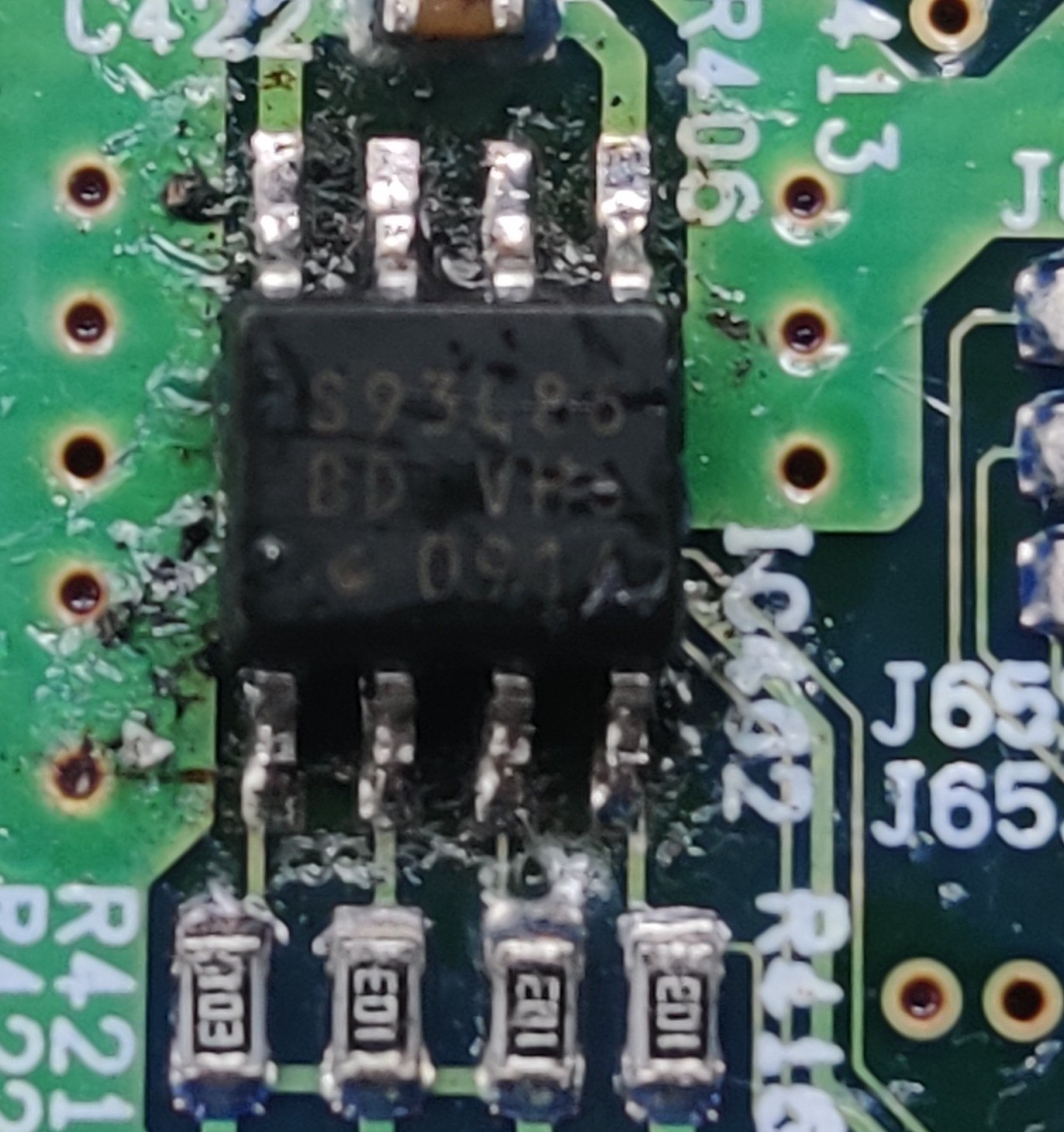

Photo: I'm glad I took a photo of this before removing to try to read the chip number with the micro focus on phone camera. There is no pin 1 marking on it. The board coating also melts and obscures the letters.

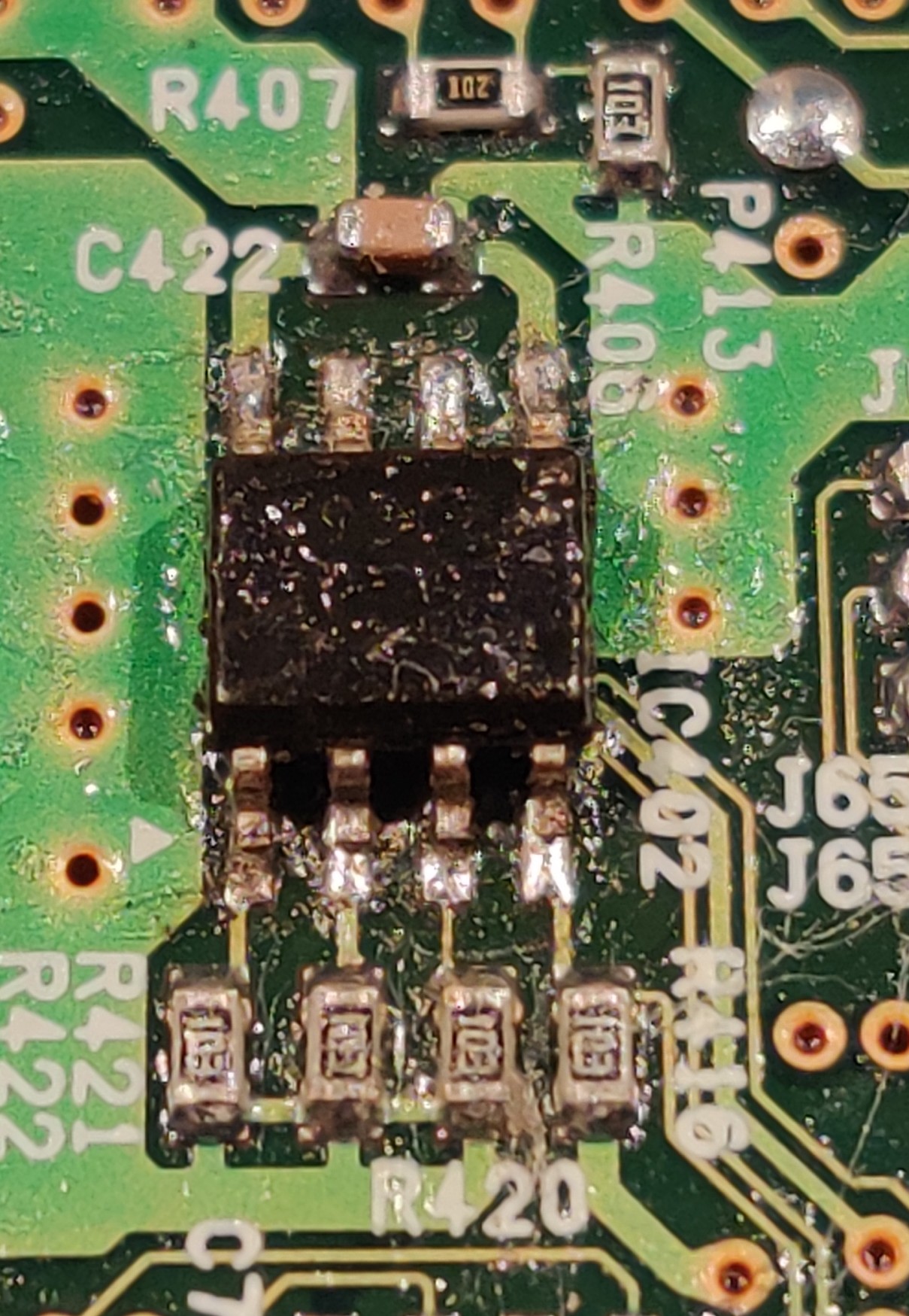

I swapped the immob chip back on to the first ecu (will post image of connections) after double checking the ROM against my initial backup read, so should be back to square one. No DTCs. I guess I have to tow it to someone with an SSM.
Photo: chip is soldered back on. Don't think I damaged it or the nearby passives. I used masking tape, then aluminum tape, then foil cover before using heat gun with cone to remove.
Also the immob chips have a two digit number on the back to keep them from getting mixed up.

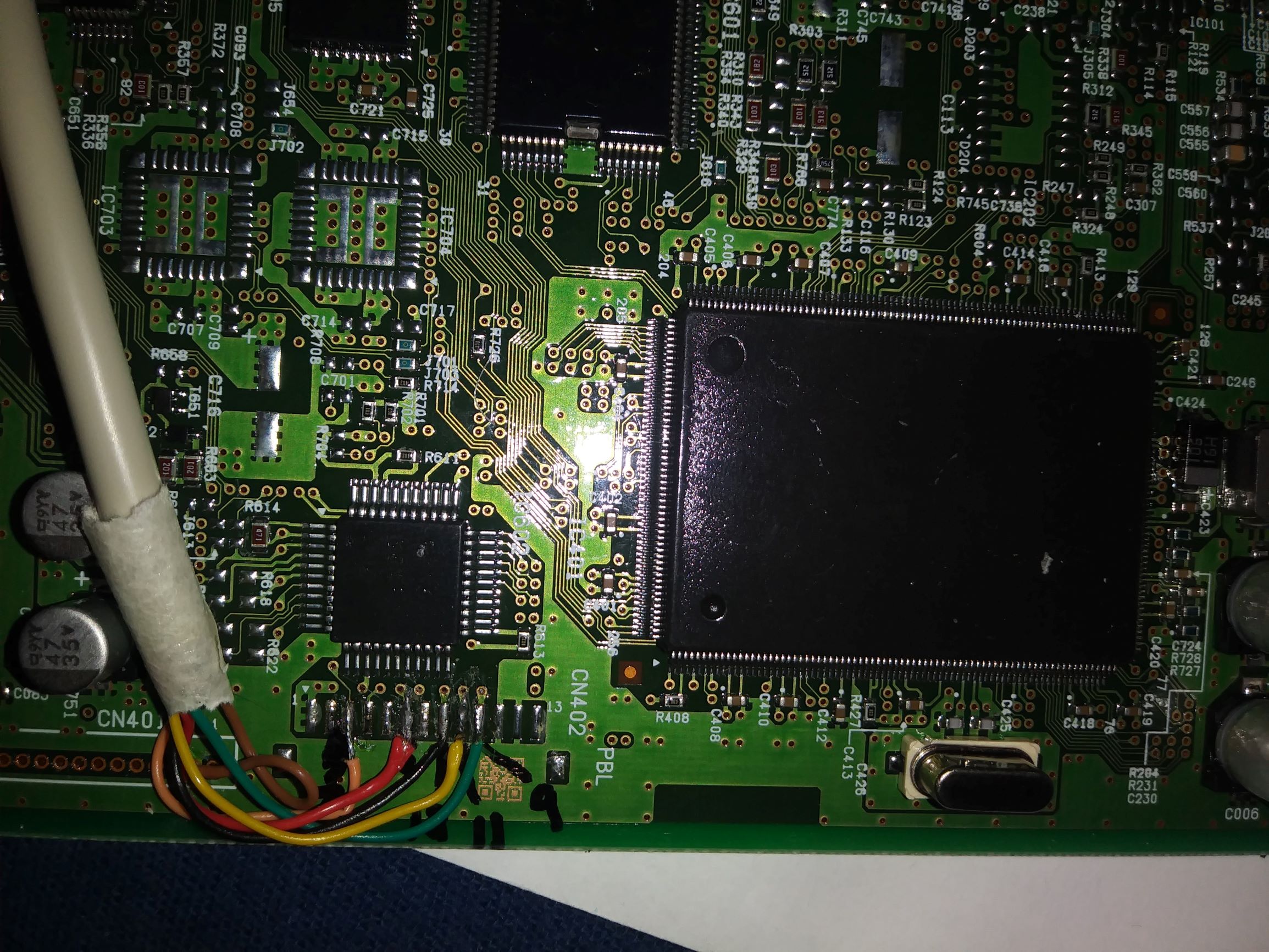

Thanks Suba Imp, I always wanted to take electronics but never did. Have some experience, but nothing this small.
So I took your advice to check the leads. They sure looked contacted, but I think this board coating is getting in the way even though I fluxed and added solder to the chip pads. I checked and one wasn't connected. So I resolder it and tried to start. Didn't start. But then I thought the only thing I hadn't checked that I could now is if I somehow mixed up the immob chips before I saw they are numbered on the back. So I put the spare chip back on the 2nd ecu. Checked the leads immediately this time and pin 3 or 4, middle two on the bottom, the one to the left in the photo wasn't connected, even though it sure looks like it. And anyway, long story short, it started! So big thank you buddy!!!
EDIT: Holy crap it works!! I flashed the modified ROM and it starts! Wow, such a long journey..
