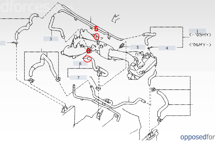

Sry to bumb up the thread again, but I'm not really sure, what exactly to cap off for doing a save boost leak test (must go to 30 psi). It looks like, that not everbody do it the same way.
I attached two pictures. Do I have to cap off all marked lines + take off the oil cap? Can someone confirm that please?
And when I want to pressurize the engine directly into the throttle body, do I have to cap off only the Nr 4?
Lines...
1. boost solenoid return (why cap this off?)
2. hose vacuum to purge valve
3. hose vacuum crankcase breather lines to the left and right head (PCV)
4. hose (pressurize or vacuum) to purge valve (why cap this off?)
5./6. hose vacuum crankcase breathe middle (PCV)
