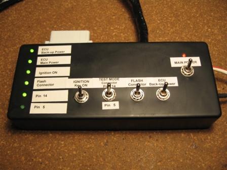

there is a difference in pin location between V7 and V8 and above. I have both versions in different cars, plus on my bench tester/flasher (see pict), i have a switch that allows me to switch between the 2 pins :D

Thats pretty cool. I never remember changing the pins, even on my V9 spec-c ECU. But I must have!

If you are running USDM WRX harness, and V8 or above JDM ECU, you don’t need to re-pin, as they both use pin-14. It is only V7 STi / WRX if I am not mistaken that you need to mod.
but if you put in 01+ JDM engine or AVCS heads, then you need to run extra wires also, but that is another thing...
