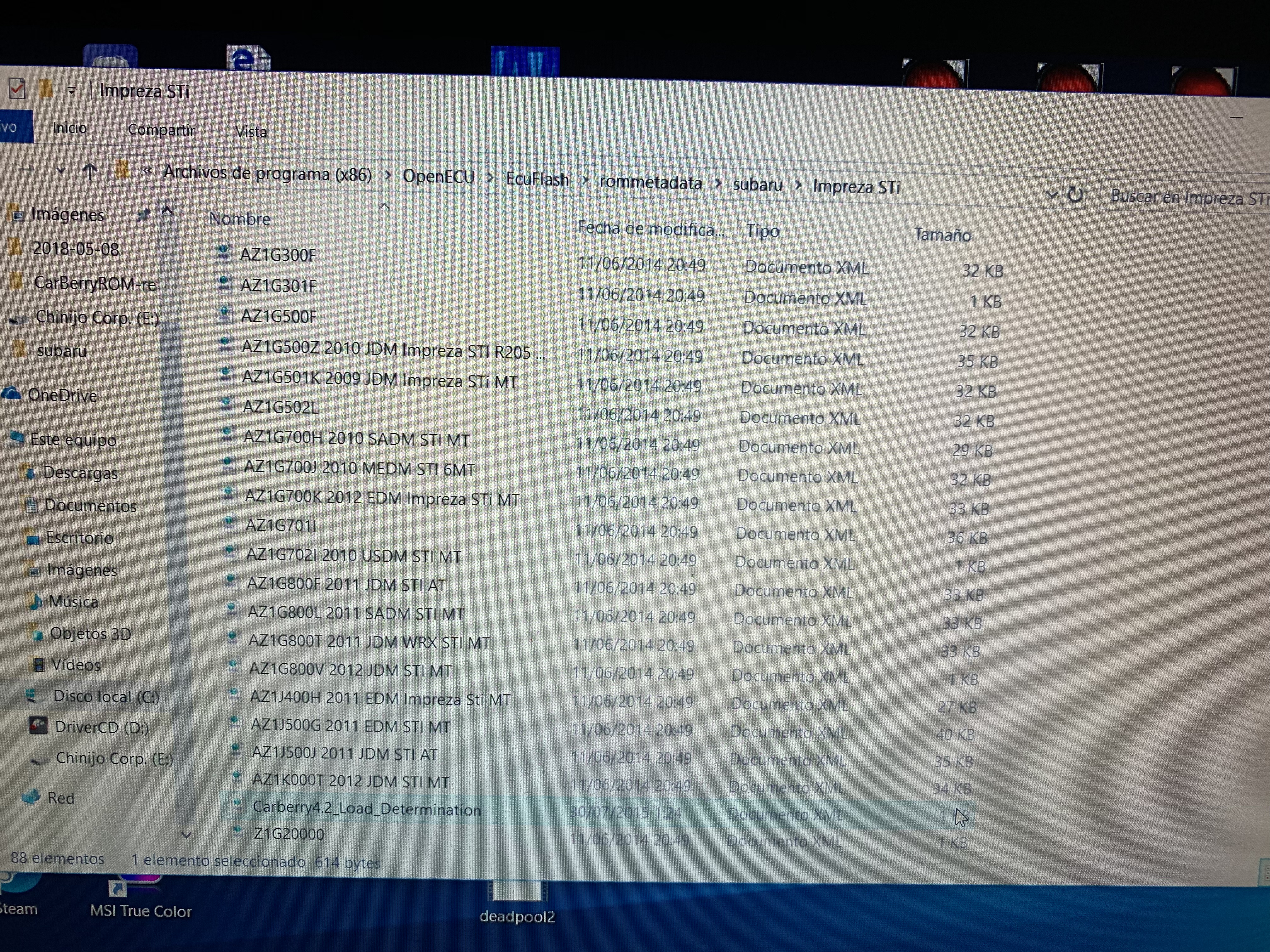

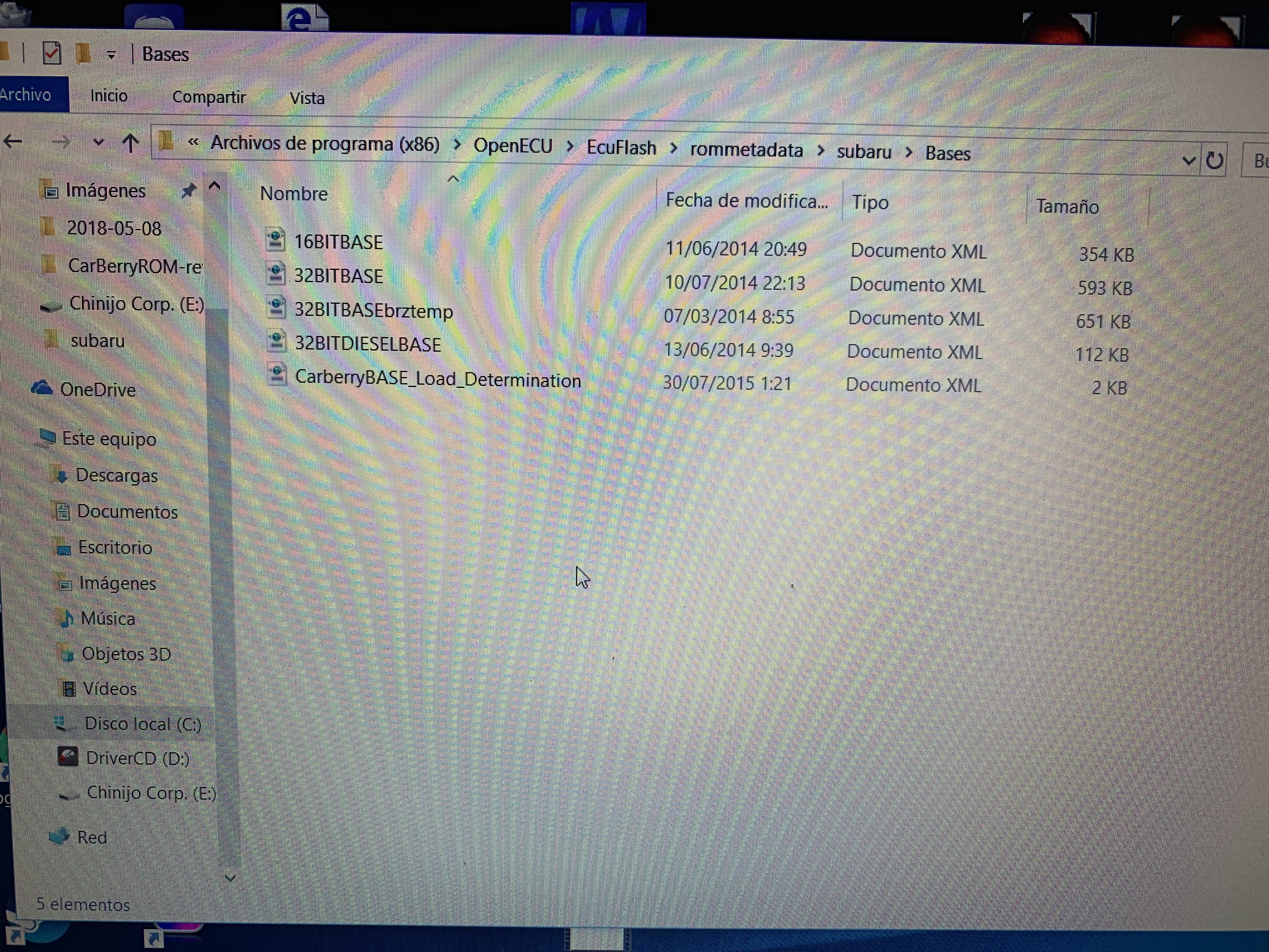

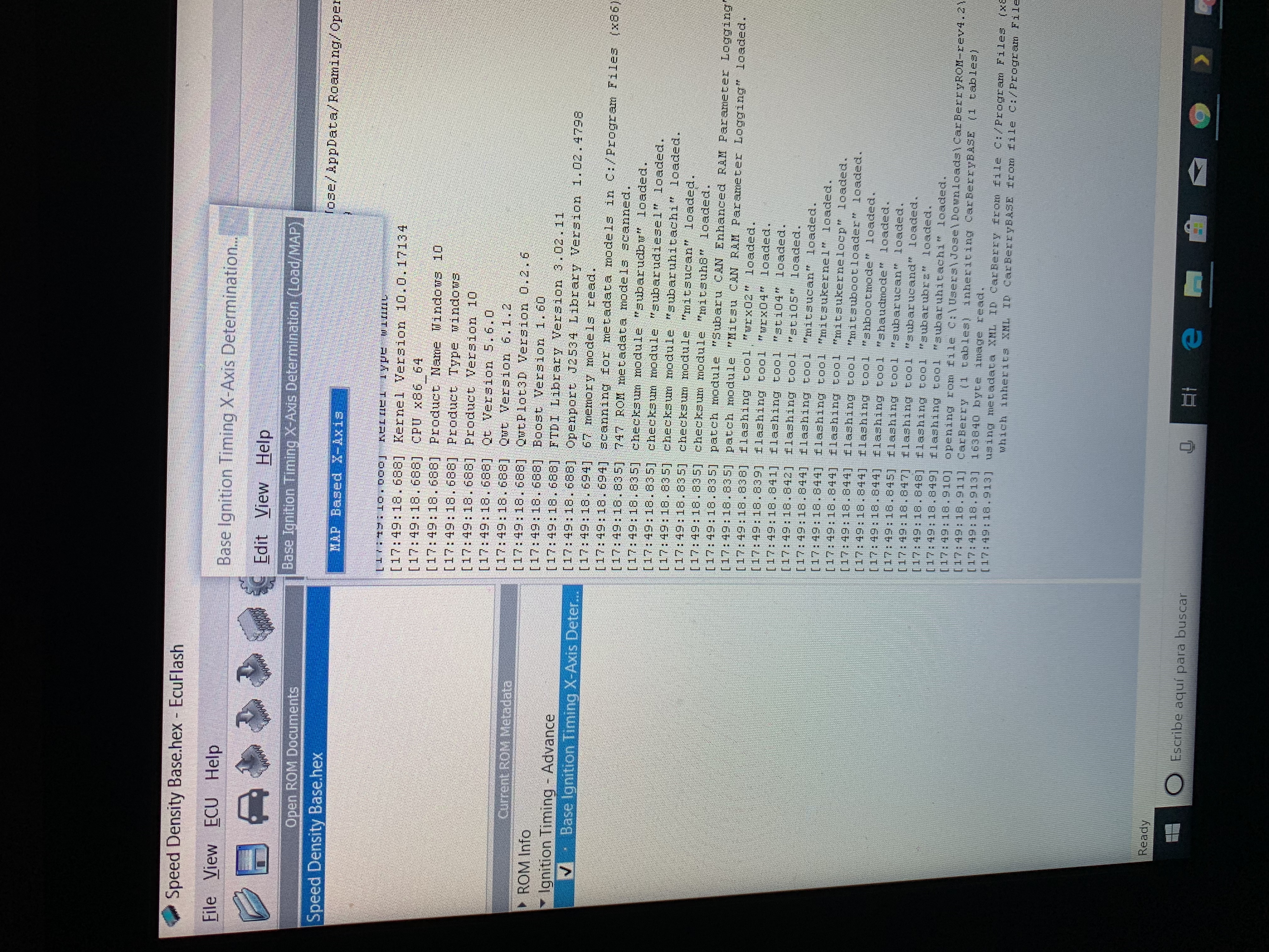

I have a problem, and download version 4.2 and put the files of the LOAD folder in the subaru / base folder and in the subaru / imprezasti folder. e patched the speed density map but when loading it with the ecuflash I only see this. What did I do wrong?
 Post subject: Re: CarBerry ROM - EcuFlash Definitions
PostPosted: Mon Dec 10, 2018 6:35 pm
this is correct for the load base determination definition. now choose if you want map or maf based load and save your rom. close ECUflash replace the load determination file with the maf or map definition file (depending on your chosen scale). Open ECUflash again then you should see all the tables.
