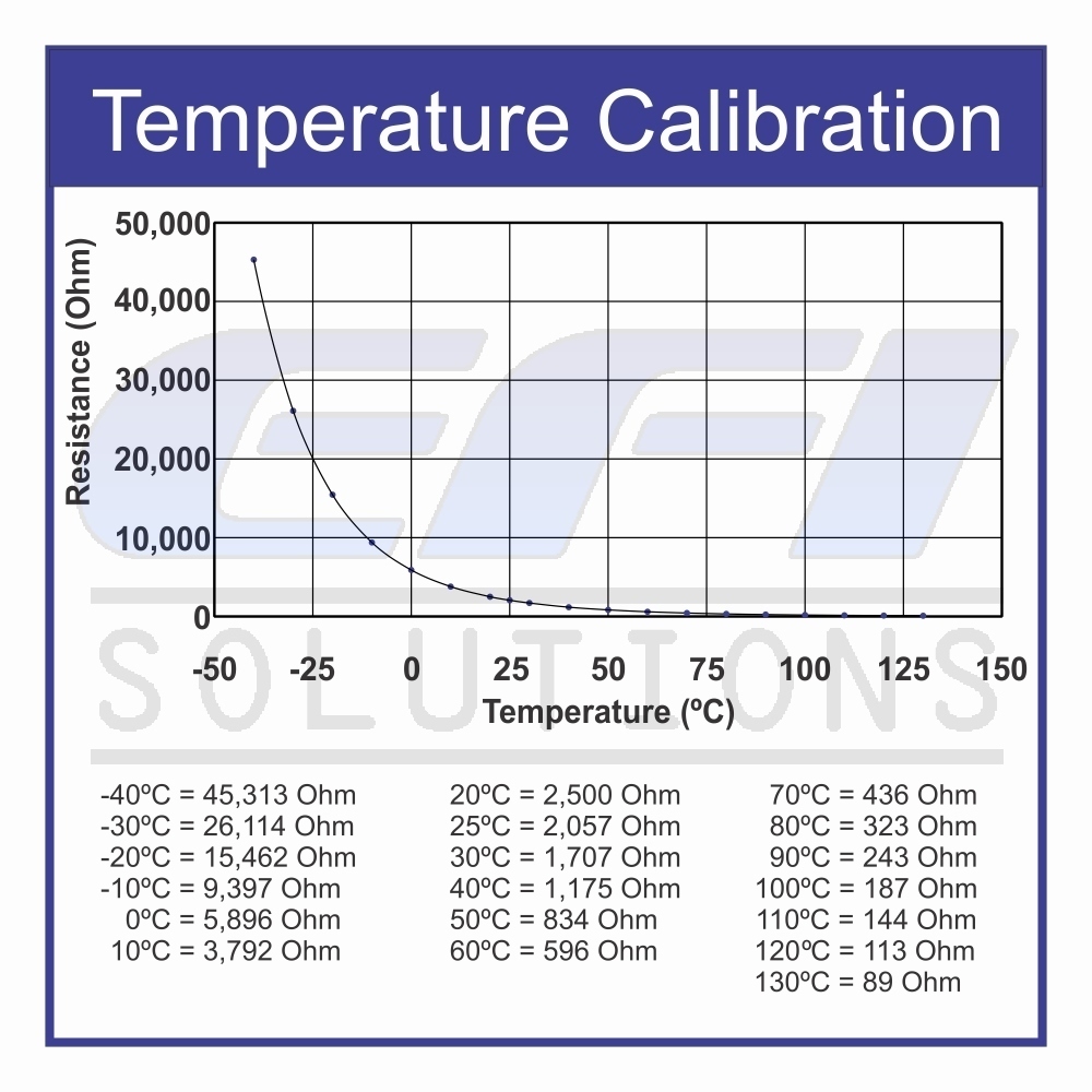

I know this is an old thread, but im looking at the 3Bar Bosch TMap sensor now.
It seems there's new sensor calibration data for the temp sensor, than what is shown in here though.
Based on the Calibration chart from Bosch (https://www.efisolutions.com.au/assets/ ... 31-030.jpg) the voltages (based on the spreadsheet and formulas posted above) are much more reflective of accurate temps...
I get these voltages for the supplied range of temps/resistances, assuming a 5v supply and 1229ohm internal resistor.
0.3376327769
0.4210134128
0.524399126
0.6633733239
0.8254076087
1.040592784
1.309309309
1.632876712
2.021328163
2.443843594
2.907016349
3.129945222
3.352105122
3.776140211
4.13754386
4.421701487
4.631837517
4.775262407
4.867968716
I think I'm going to give it a go and see if I can get it working irl.
