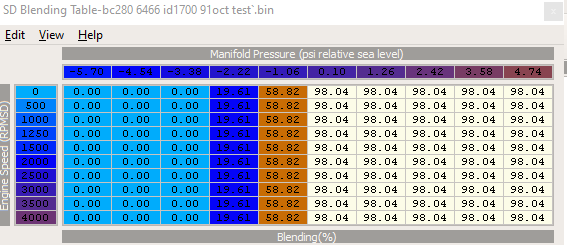

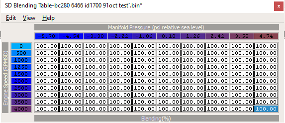

I noticed in your rom the SD Blending Table is wrong, the table should be all set to 100%. I tried this and it also didn't work but maybe it'll work for you
