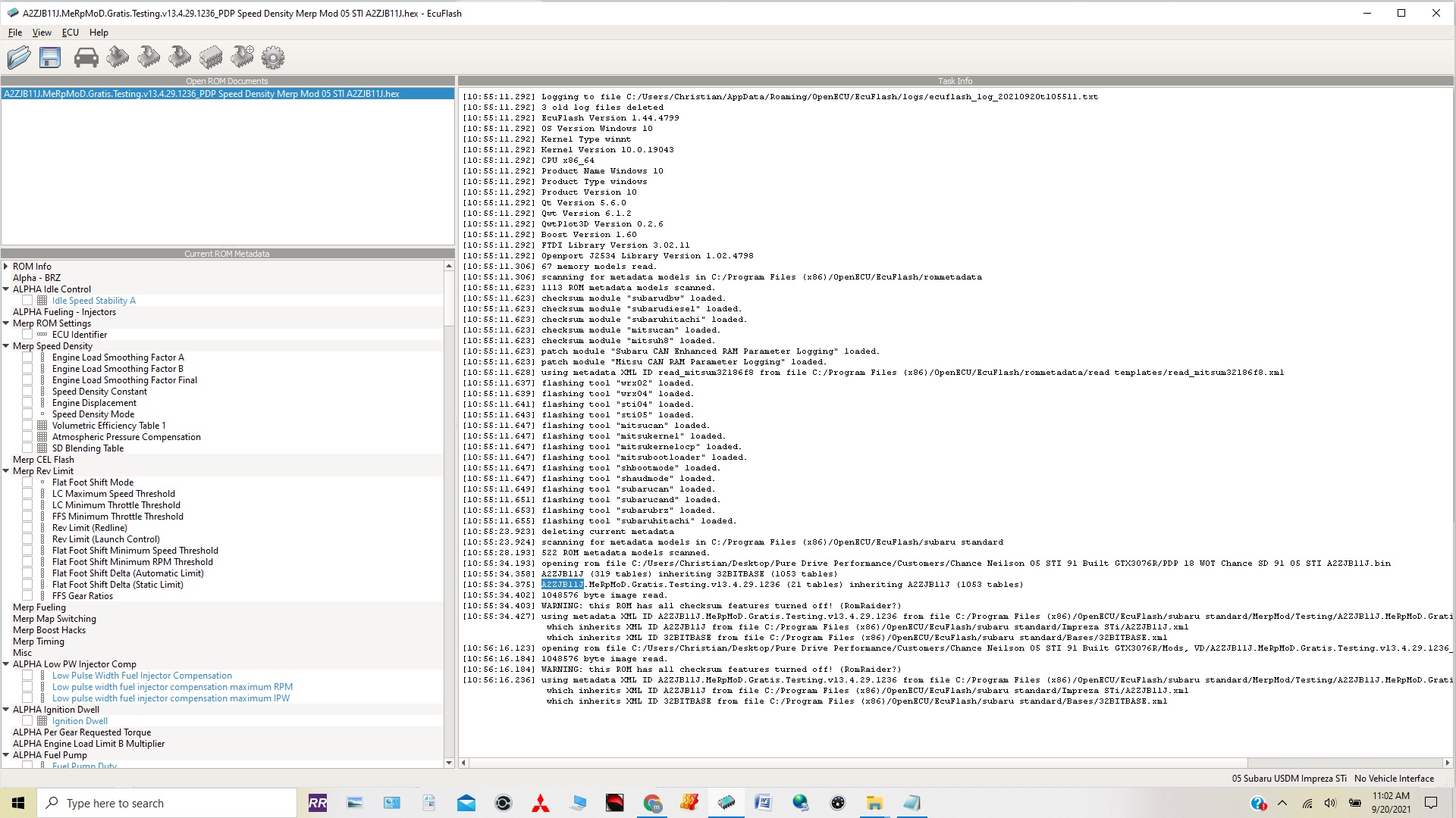

Tuning a 05 STI USDM on a MerpMod A2ZJB11J patch. Everything is working great for idle and cruise, but now getting into boost and it's hitting a boost/fuel cut (like a rev limit). From the logs it doesn't appear to be fuel cut, but it's definitely stopping around 4300 RPM. I think it may have to do with the areas of the MerpMod tables that I can't see. In the attached pic you can see some merpmods available, but the others aren't. It's not greyed out. Not sure if I need to do something to the definitions (best guess) or I'm missing something else. Help! Thanks!
Some additional info: I set all the rev limiters that I can see to around 7K RPM and speed limiters to like 300 mph for testing and that doesn't make a difference. I read that the stock rev limiter won't be used. I can see and adjust the merp rev limits (those are all set to 7200).

It appears you have all the right tables for that Merp patch. Try disabling Flat Foot Shift.

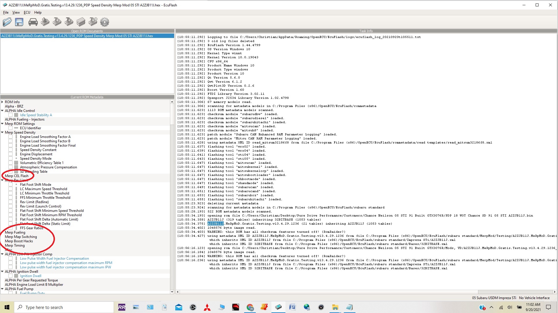

Thanks I'll try that out.
So these tables circled in red don't have any drop downs or tables. So some ROMs have these and others don't?
