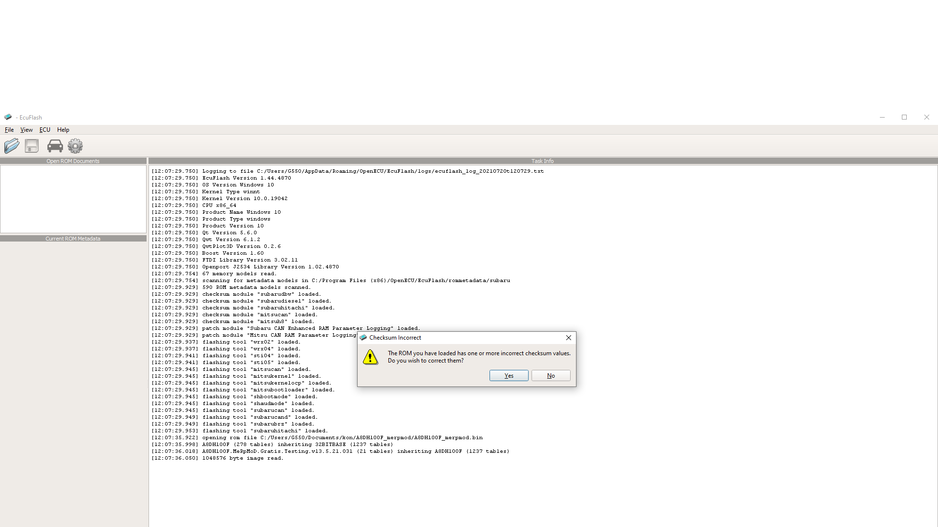

 Post subject: Re: Speed Density FAQ
PostPosted: Tue Jul 20, 2021 7:54 am
Joined: Tue Mar 12, 2019 9:13 am
I'm posting my results after trying to open the files attached.
obviously I'm not doing something correctly.
Do I have to modify or combine the definitions the stock A8DH100F with the merpmod A8DH100F to make it work?
Results.zip [778.98 KiB]
Downloaded 227 times
PostPosted: Tue Jul 20, 2021 9:06 am
This is what my log window looks like.
PostPosted: Tue Jul 20, 2021 9:10 am
and this is when I try to open your file.
I'm a little bit confused right now
