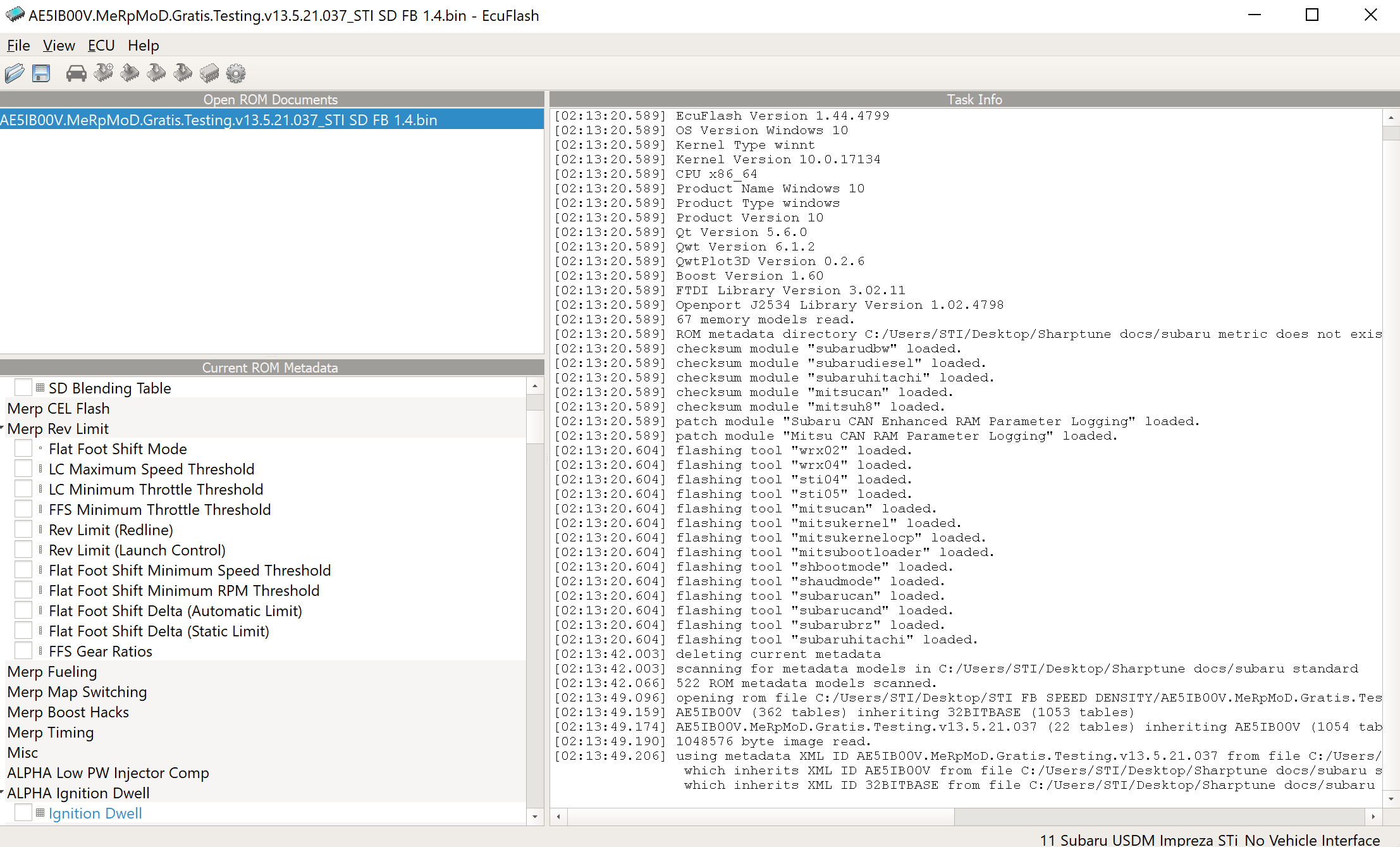

Have any of the gentleman with this problem found a way to solve it? All of the Merp tables are greyed out for my AE5IB00V. I've redone all of the definitions multiple times, reinstalled, all to no avail. Searched through the forums and couldn't find any solutions. Any help would be much appreciated...
Merpmod for this ROM appears only to exist in 'Gratis' form. You won't be able to obtain any further tables without the later 'Switch' versions being ported to your ROM.
You can try your luck Here or Here
