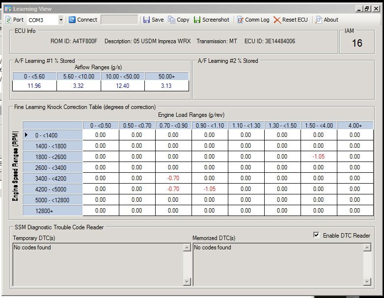

So I may just be the newest and most retarded person to ask this, but why does my screenshot of Learning View look like this:
I mean, why all 0s? That helps me in no way, correct?
I was referred to this program by someone who is trying to help me figure out why my IAM never goes all the way to 16 and just stops at 15...

The entire FLKC table is cleared evertime the IAM changes. I'm assuming you are the guy that posted on Nasioc about his IAM being stuck at 15? Looks like you recently did an ECU reset. You have to wait for the IAM to "settle" before it switches over to FLKC mode and will start populating the table, if necessary. After a reset, the ECU enters rough correction (IAM) mode.

A learning view right after a reset isn't going to tell you anything. I would just periodically check it. You many want to be logging as well if the IAM is all over the place.
Well, good news is my IAM is now at 16! It has never gotten to 16 before! Not since I flashed to Stage 1 a while back and have been logging and stuff.
What do you think of this now:
I'm thinking the red values indicate...badness?

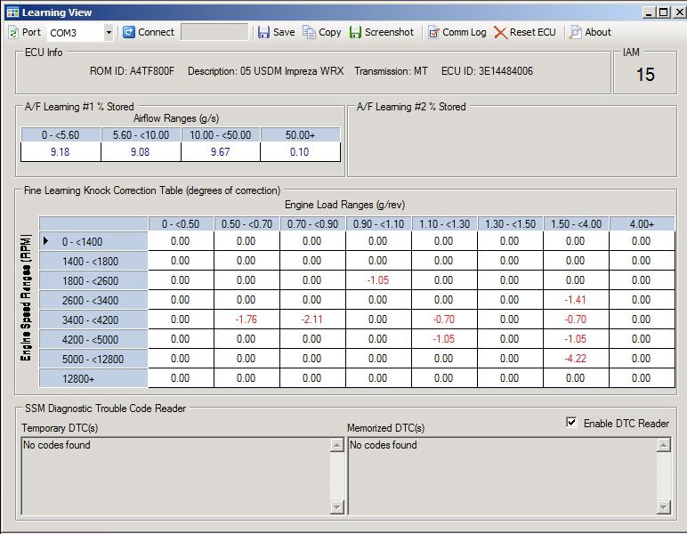

So I can't imagine this is a good thing, eh? Gots me all kinds 'o worried I've never seen it this bad...
You have learnt knock. All those areas that are in red text are rpm/load points where knock has occurred. It is actually at the point where you have dropped out of fine learning and back into rouch correction and your IAM is now dropping down to 15.
I'm not sure how other people do it, but here is how I have been doing it:
  1. First log AFR using WB02 and check that the AFR is not too lean at the rpm/load points that are red.
  2. If AFR is fine, do a quick, rough, cleanup. Halve the red text values in learning view and then take that value away from the rpm/load region in your base timing table.
    Eg. at 0.50-<0.70 load and 3400-<4200 rpm you have -1.76. Half of -1.76 is -0.88, so edit your base timing table and subtract 0.88 from all the points that are in the 0.50-<0.70 load and 3400-<4200 rpm region
  3. Now go do 1/2 throttle 3rd and 4th logs as well as WOT 3rd and 4th logs from around 2000rpm-redline, and log engine load, engine speed, FBKC, FLKC, WB02 and ITT.
  4. If at any point during any of the logs you get constant knock, stop logging, open your log file, find the point where it knocked, halve the value, and then take that away from the rpm/load point(s) in your base timing and try again.
  5. Once no knock is being reported while logging, you should be fine - but still check in learningview periodically. If you do happened to see red text in some of the learningview cells, repeat the steps above.
    Note: it'll take a while for the ecu to go into fine correction again and for learningview to start displaying learnt knock again after each reflash.
That is what I do, ppl do different things, I'm not sure exactly why I halve the FBKC/FLKC/learningview knock values, I guess I didn;t want to start taking too much timing out if I didn't need to, but anyhoo it works well for me at stopping knock.
Maybe one of the more experienced tuners can comment and if this is an inefficient (or bad) way of correcting knock, maybe they could post up a better method :)
EDIT: I also just noticed your A/F learning is out by over 9% across the board - you want to try and sort that. I'm guessing you have installed a CAI or short-ram pod filter, if so, you will need to rescale your MAF (using either the spreadsheet or the MAF tab in RomRaider Logger), until A/F learning is no worse then around 2%.

Thank you very much for the advice, but I'm running Cobb's OTS Stage 2 91oct map and I'm starting to think it's crap? I can't modify anything...and no, I don't have a CAI or SRI installed and I just actually cleaned the MAF and reset the ECU a few days ago. I also installed a Walbro fuel pump last week with the Walbro sock thingy instead of the stock OEM one, and I'm wondering if that could be part of the problem maybe?
And here are my logs:

Which "stage 2" map are you using - there are a few of them. If you are going to use a Cobb "stage" map, make sure you use the one that is most similar to your setup and the fuel you use.
What mods do you have?
Lastly, why can't you edit the tables? I thought if you had a Cobb AP and one of their free stage maps you could actually edit the ROM tables as you needed?
