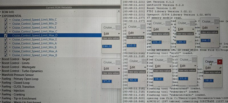

When an ecu has the 8 Min/Max settings have we figured out what each does?
throttlehappy wrote:
Hex Values for the JDM 2L LGT is 42 14 00 00 42 20 00 00 42 18 00 00 42 14 00 00 42 1C 00 00 43 10 00 00 42 DC 00 00 42 D2 00 00 43 7A 00 00 43 10 00 00 for anyone else looking
Thanks to Oren for finding them in A2ZJD01A :)
2005 Outback XT A2WC521R had the same hex starting at C19A8 (seems like all 2005 dbw turbo models may have this hex somewhere). The values seem to be stored as KM but I especially don't understand the 110 and 105
<table name="Cruise_Control_Speed_Limit_Min_A" category="EXPERIMENTAL" address="C19A8" type="1D" level="1" scaling="rawecuvalue"/>
<table name="Cruise_Control_Speed_Limit_Min_B" category="EXPERIMENTAL" address="C19AC" type="1D" level="1" scaling="rawecuvalue"/>
<table name="Cruise_Control_Speed_Limit_Min_C" category="EXPERIMENTAL" address="C19B0" type="1D" level="1" scaling="rawecuvalue"/>
<table name="Cruise_Control_Speed_Limit_Min_D" category="EXPERIMENTAL" address="C19B4" type="1D" level="1" scaling="rawecuvalue"/>
<table name="Cruise_Control_Speed_Limit_Min_E" category="EXPERIMENTAL" address="C19B8" type="1D" level="1" scaling="rawecuvalue"/>
<table name="Cruise_Control_Speed_Limit_Max_A" category="EXPERIMENTAL" address="C19BC" type="1D" level="1" scaling="rawecuvalue"/>
<table name="Cruise_Control_Speed_Limit_Max_B" category="EXPERIMENTAL" address="C19C0" type="1D" level="1" scaling="rawecuvalue"/>
<table name="Cruise_Control_Speed_Limit_Max_C" category="EXPERIMENTAL" address="C19C4" type="1D" level="1" scaling="rawecuvalue"/>
<table name="Cruise_Control_Speed_Limit_Max_D" category="EXPERIMENTAL" address="C19C8" type="1D" level="1" scaling="rawecuvalue"/>
<table name="Cruise_Control_Speed_Limit_Max_E" category="EXPERIMENTAL" address="C19CC" type="1D" level="1" scaling="rawecuvalue"/>
 Post subject: Re: Request: Cruise control speed limiting tables
PostPosted: Wed Nov 06, 2024 2:37 am
Joined: Sat May 10, 2008 8:50 am
Posts: 20

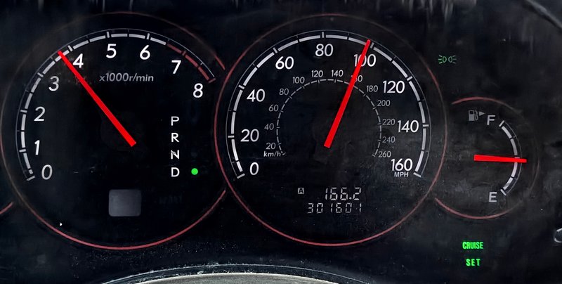

Added 33 to all max settings and confirmed the change was successful. Still curious when each of the four settings are in effect.
