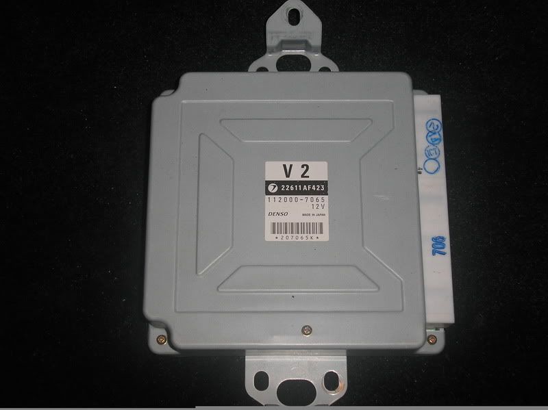

Here are the #'s on the ECU I'll be testing:

Results are in...
It works. I copied my tune in from my A4TF520F 04 ROM and away I went. A few tables in the 02 are slightly bigger, so I get a bit more resolution out of the deal as well :)
