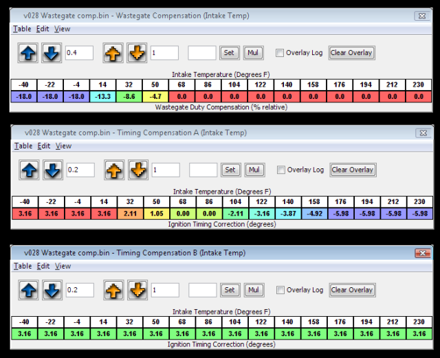

I'm guessing these tables exist so that one doesn't need to:
(Though I am curious why the last one is flat.)

The final decision to drop the IAM is always based on the knock signal, nothing else.
