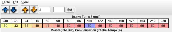

I took a look at compensation tables, but they don't seem to make any sense to me? Can someone elaborate?
For instance. The attached map. 68F - 86F means 50 (but 50 what? 50% increase in WGD?)

PostPosted: Wed Apr 19, 2006 6:32 pm
Joined: Fri Mar 24, 2006 3:14 pm
Posts: 768
What this means is that the wastegate is allowed an additional X% to achieve target boost if target boost is not achieved with the BASE values. All of these compensation maps co-mingle with eachother to achieve your boost.
PostPosted: Wed Apr 19, 2006 7:05 pm
Joined: Mon Feb 13, 2006 6:27 pm
Posts: 226
That map is not consistent with the maps I've seen.
The compensation removes duty cycle <= 50 degrees and leave the duty cycle alone above there- at least with the stock values.

PostPosted: Wed Apr 19, 2006 7:23 pm
Posts: 768
Mike
Could be, don't change any other settings and set the values at 68F and 86F to 0 and see what happens. Then try 100 and see. Experimentation is key to tuning and discovery.
