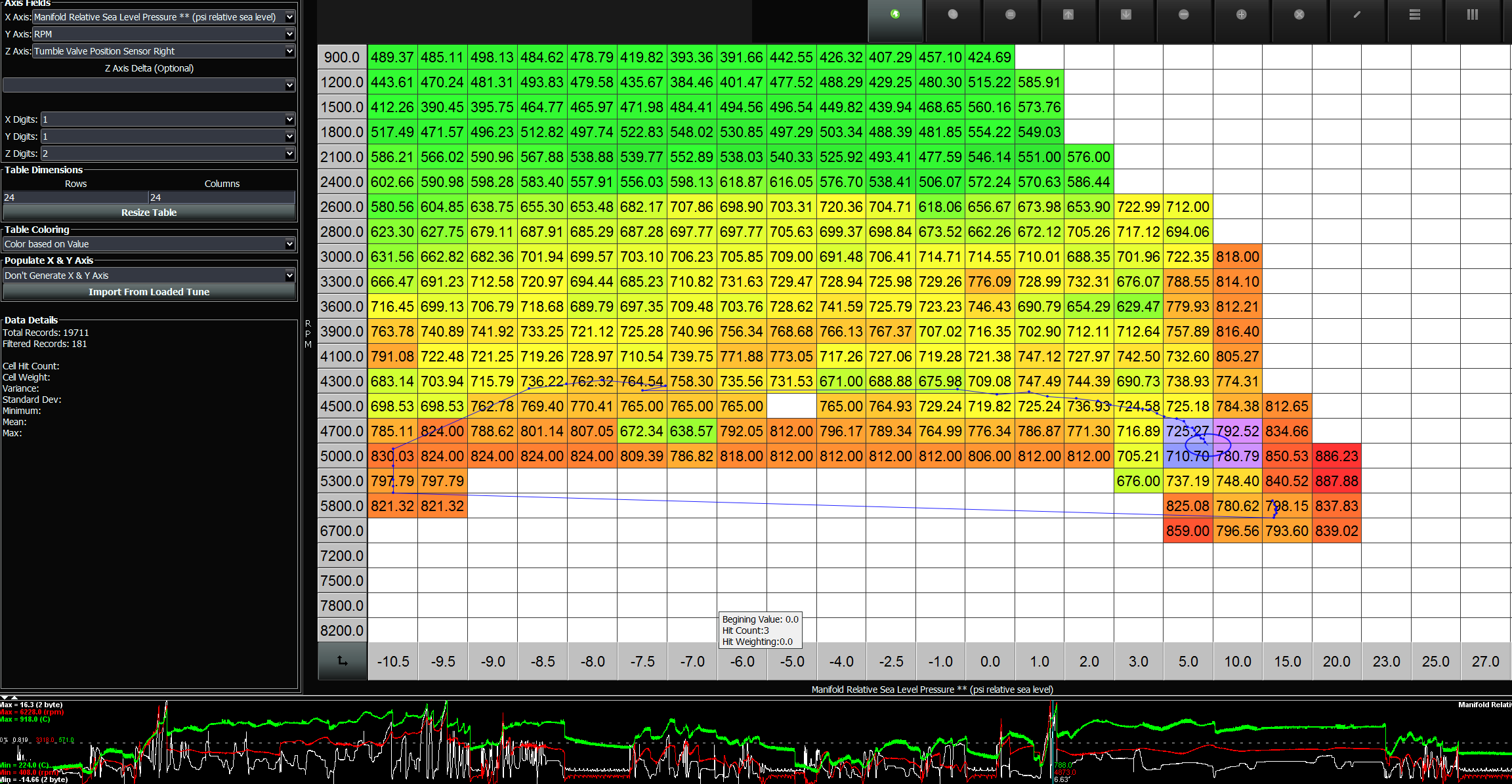

File comment: Romraider data-log showing EGT/AFR sensor data using the left and right tumbler valve inputs.

File comment: EGT in Celsius logged through the computer.
