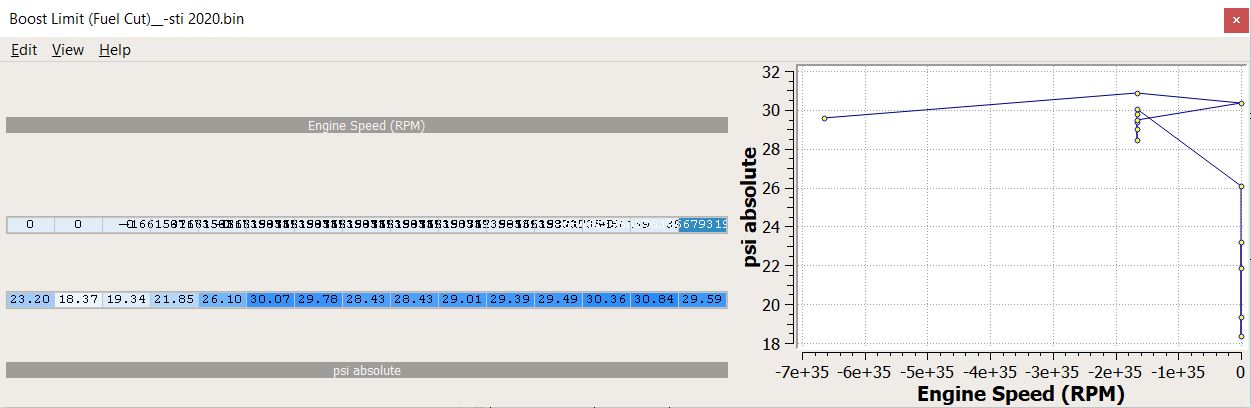

Hi! I noticed an oddity with Boost Limit (Fuel Cut)_ and wondering if it's just my base???
I did download the latest 32BITBASE from git, other roms (AE5T200V/AE5T201V) show the table as they should.

Is it related to this?
viewtopic.php?p=166039#p166039
This is what my defs show:

I downloaded and overwrote what I had in the EF meta directory and it shows up correctly now. :?
Not sure how that was jacked up, I didn't mess with anything in that file.
