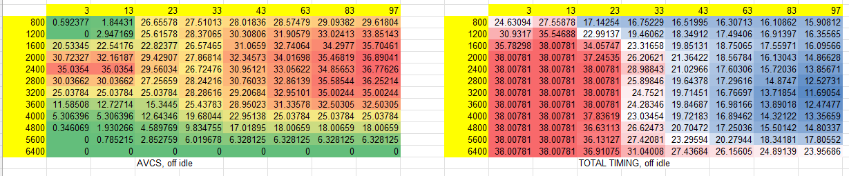

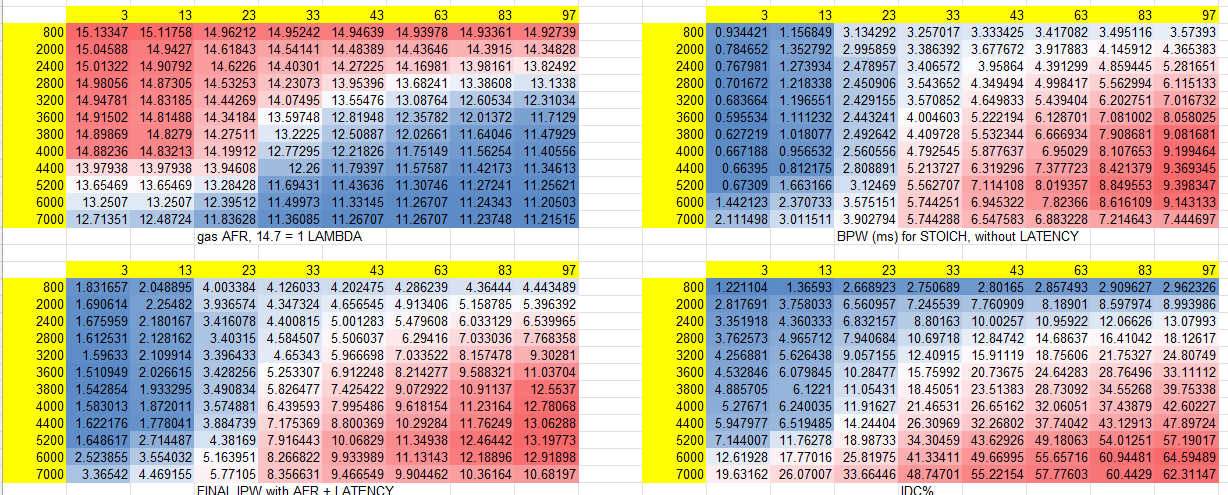

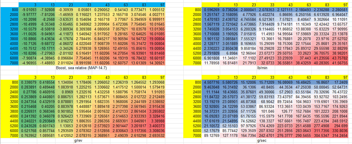

Fairly certain my Blouch 440XT is just a TD05H-20G 8CM, which makes my setup fairly similar. What is most dissimilar, is the calibration ID you're using. You may or may not be able to modify the ROM I'm using and flash it onto your AT vehicle with or without changes in shifting behavior or DTCs. The rules on how this applies is a bit fuzzy, but it changes depending on year/generation of ECU.
Also, I'm a big fan of the TD06SL2 wheel versus the TD05H wheel when working with 18/20G and larger compressors. Your turbo is more likely the one I would rather have. Although, I'd get it in 7cm with the STS55 turbine. :D
Here is a cold start video that I made recently, after getting some miles in on my new 'mufflers' and dialing in alpha idle tables:
https://www.facebook.com/share/v/qaN3nF24HCJfGkH8/
BPT 440XT 8CM
UEL Headers
Catless, divorced downpipe 3"
3" midpipe with long bottle resonator
dual 2.5" to Yonaka mufflers (not chambers, they're muffler sized resonators)
ID1050x, 06/07 rails/FPR, AEM340, Billet TGV-less housings
GFB variety dual port thing, CX Racing FMIC, 3 port MAC valve
Cobb Turbo inlet, 3" intake, no MAF, SD with IAT in cold side charge pipe
Your hurdles to tuning for newer to the tuning experience include tables you've never heard of, and/or tables that are probably not defined in your definition set, such as low pulsewidth tables, decel fuel cut, and misc. other tables.
So, even if I posted up my ROM, and even if I posted up my expanded definition set, you would still be missing your definition set for your calibration ID, for the extra tables that arguably make tuning and driving more enjoyable. The solutions to this are to have them defined for your ROM, or run a compatible ROM that already has them defined. It's entirely possible that my ROM *could* flash to your vehicle and the TCU and other control modules may or may not care, but it would still need some work for the differences in setup. SD vs MAF, you didn't mention TGVs, etc.
Namely, you mentioned altitude/baro considerations. What I generally always do is get the system to target near as close as possible to the same pressure ratio at the compressor. This is basically trying to scale the target boost compensations to not always read out as what the target boost table looks like at face value, even with zero boost error, when you are programming the table. It's referenced as boost at 14.7 psia baro, but it's actually an absolute pressure target system. This is why I never log any 'boost' named pressure paramaters. MAP (not MRP) and boost error are the only ones you really need. In either case, at a higher density, lower altitude, the same pressure ratio can be a higher boost, making more power, but the same boost at a lower density/higher altidude would be a higher pressure ratio. If you're running near max wheel speed here, then what happens there? So I tune it to try to reach the same pressure ratios/wheel speeds at all altitude/baro pressure. This simplifies the system at the expense of maybe not having it consistently pushing the boundary of wheel speeds and pressure ratios (but accurately) at all altitudes, and thus making the most power wherever you are, for the turbos that aren't already tuned to the edge at sea level.
What's good on a timing table or fueling table at one altitude is good for another, they're airmass based. The difference in altitude is air density. It's calculating air density already. What's good here is good there for the basic load axis tables.
I'm going to post up my ROM and definitions on my own thread this weekend after I make some final adjustments to some tables, but here are some things to go off of.
I tune DBW to be 1:1 with torque request/pedal movement, and use 33%+ throttle opening, but primarily 63%+ for wastegate duty to dictate boost/torque/power. Better and more predictable torque response to foot movement, IMO. Rewards a sensitive foot, and with proper tuning of tip-in enrichment and low boost error, responds immediately to aggressive throttle movements.
I made a spreadsheet where you input the VE table, timing, target boost, fuel tables, SD multiplier/displacement, and injector settings, and it spits them out in respect to the load achieved assuming target boost table is accurate.
Anyways, what's your calibration ID? Can you post up your ROM? If you're using a user posted ROM from the forums, you can link to that. This weekend I can look at the ROM and see about defining the extra tables for you.
File comment: targets @ 86F IAT / 186 ECT, where nearly all compensations are zero and is considered the 'frame of reference'

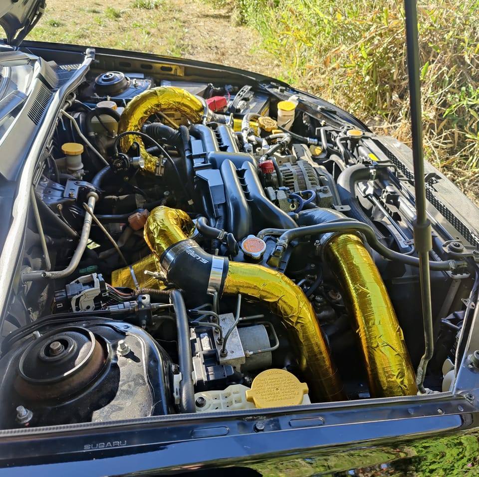

Alrite guys, I have finally got the front mount kit installed as well as I have a pump gas tune for 91 on stock vf40 pushing 18-21 psi a friend gave me making approximately 326hp at crank via virtual dyno. I have the FPR set at 55 psi base. Logs seem to say it's all good, IAM is 1.000 on WOT, no knock correction, and no knock learning. The Legacy definitely seems much happier.
After further investigation, the tune seems to be one that was uploaded here already as all the parameters match to a T, that tune being Russ-05 LGT or something like that, so instead of posting the tune, I will link the original thread so anyone wondering can download it.
I will eventually put the bigger turbo and injectors, but right now it seems happy and reliable. I might hold off on the turbo install and injectors until I have a built block because I feel on e85, it will make somewhere between 460-550hp and at those numbers, you'll blow up the stock engine in no time.
Getting ready to install a roll cage, 4 point harness, HANS & FIA approved Momo seats this weekend. This is gonna be a hot dog of car haha, put those Lamborghinis and Ferraris in their place on the track!
