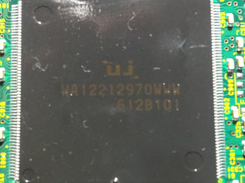

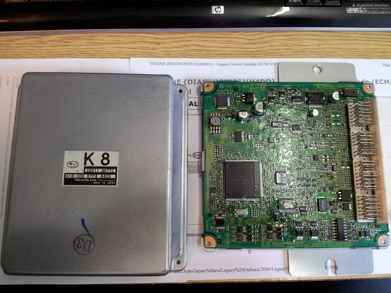

How can I know what numbers to use for Address and Length?
I have the Legacy 06 with EJ204 (AVCS) engine. The ECU is a Hitachi 22611-Ak772, the large IC on the board is marked as UJ WA12212970WWW 612B101.
Danilo

About 3/4 hour per 1 Mb.
You should see EcuID and a progress bar while reading when connected properly.
Check the length for reading. Probably you asked too long.
