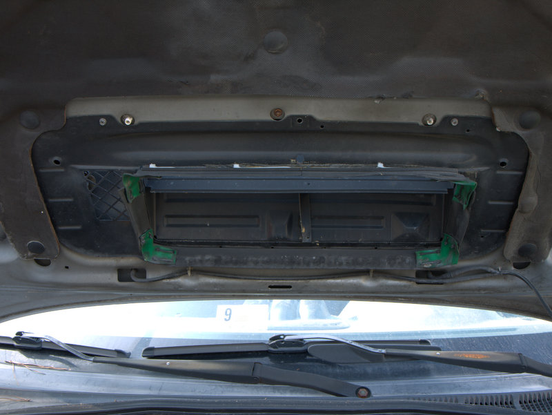

Joined: Thu Jan 29, 2009 3:16 pm
Posts: 523
I bought a splitter and bellows and it didn't fit (The Hyperflow is HUGE), I ended up cutting the bellows to expand the area that it covered and joining the pieces with rubber strips to keep it sealed. You can tell from the IC pics, there is still a lot of the IC that is covered by the bellows.
