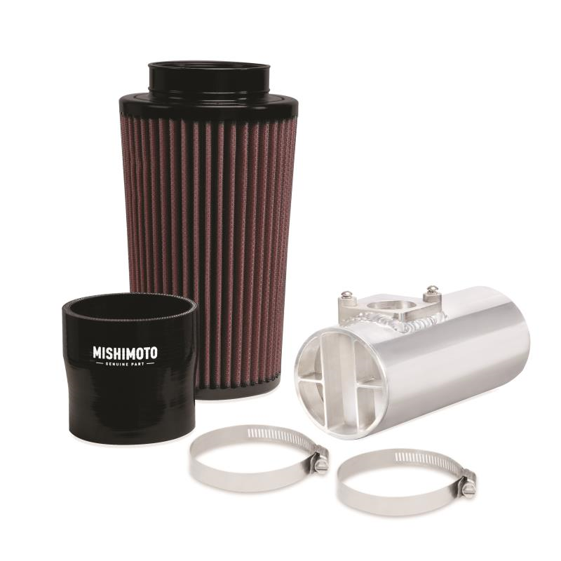

Here is pic from mishimoto web

that design looks like it would scale weird and probably have AFR drift with IAT swings
I'd vote stock intake over that intake.

PostPosted: Thu Dec 12, 2019 3:39 am
if you look at the cross section of the diverter / straightener area, at low flow it should have more air over the sensor
and at higher flow it looks to be restrictive
thus, higher g/s at low voltage and lower g/s at high voltage
if your software is scaling the sensor and your fueling error is getting within 1% everywhere, then you're for sure doing it right - just that this intake isn't going to work for anything more than a TD04 with it's stock voltage axis.
