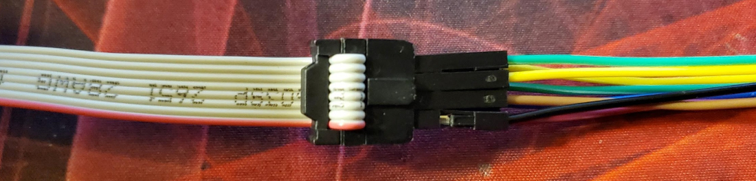

Cable / Wire to connect between programmer and clip. Preferably different colors
and male to male ends. ( Pictured Below )
File comment: Cable / Wire to connect

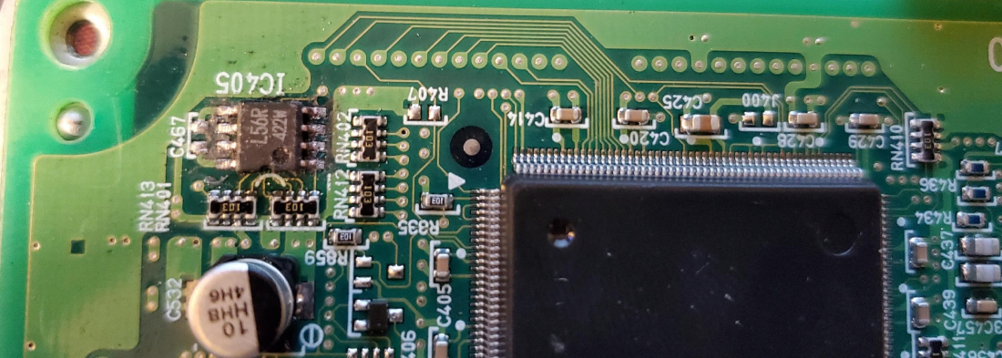

ECU EEPROM:
With ECU main connections facing you, the EEPROM is in the upper left corner of the ECU.
EEPROMS on these boards have 8 pins, 4 on either side, and are marked either L56R or 93c56R
These are both Micro-wire EEPROMS. The Ecu uses 5v and the BIU uses 3.3v. Will show in system as 93c56R – Make sure to choose 5V one.
File comment: L56R or 93c56R Micro-wire EEPROM

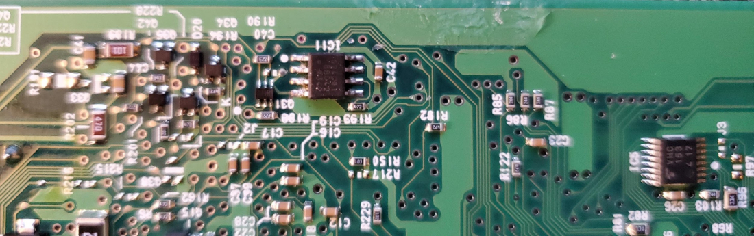

BIU EEPROM:
With the connector facing you, you must turn the board over and look at the rear of the board. The EEPROM is located near the top and middle of the BIU board. It is labeled s24c01 and is 3.3v.
Chip will display in reader as 24c16 3.3V

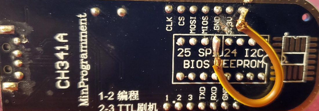

Now we need to prepare the tool for use on the ECU.

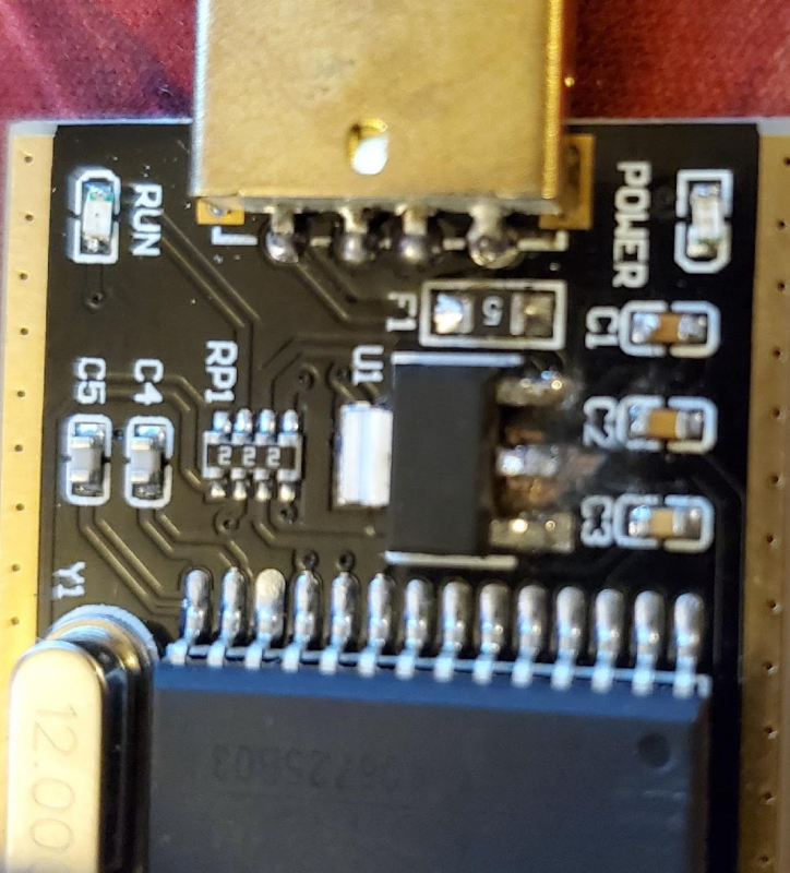

Let's start off by setting up the CH341A black edition to support the ECU EEPROM, and have it be able to put out the 5V to read the chip in the board.
You’ll need a solder Iron for this part, or you can use the jumper on the side and see if it works for you, I went ahead and did the Solder mod for 5v constant to the lower 25xxx section of the reader.
The upper 24xxx section will still support 3.3v so no worries. This is the only stage you need to add any solder to the unit, you will need to heat up one pin to remove it but this is the only stage needing solder / solder iron.
Below are the modifications to have the 25xxx slot support 5v.
You will need to connect the 5v lead from the 5 volt pin in the top right to the top right pin on the 25xx connection. My solder job is horrible, and I just used some scrap wire to make a jumper, you can do better than me, I was just going for it. You can even see the ball of solder that I accidentally dropped on the outside ring, whoops. Oh well.
File comment: 5v lead from the 5 volt pin
I also cut the trace to the 25xx on the board to avoid voltage spikes. This probably wasn’t needed. You can do it too, but it's probably a waste of time and can cause issues if you cut the ground that is close to it. But that’s what those “scratched up marks are''

Here on that center black chip – Its the voltage regulator, the middle pin out of the 3 needs to be lifted off of the board. I just took the solder iron and sat it on there for a little bit and used a pick to lift the little foot off of its pad so it won't make contact. This effectively cuts the restriction of 3.3v to the 25xxx connector.

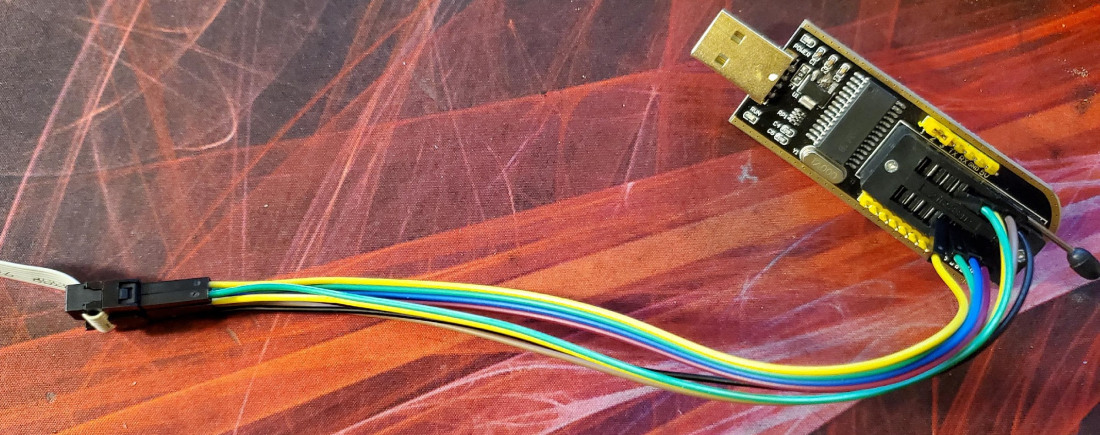

In a nutshell I just used the Male to Male wires and pushed them into the programmer by hand,
and into the connector on the clip probe instead of soldering everything onto a breakout board.
If you like to be fancy, take the supplied breakout board with the kit and wire yourself to it,
me on the other hand, I’m lazy and my shaky hands don’t solder well.

So wiring the BIU you literally just go 1 to 1, 2 to 2, and so on until you have all 8 slots connected to your clip matching up. Number one on the clip was marked with a red wire on my clip.
For BIU readout you will be using the 24xxx slot closest to the lever on the programmer.
I used the supplied board to orientate it so I knew what side was 1-4 and 8-5
See below photos: This was pinned out for BIU eeprom reading.
File comment: pinned out for BIU eeprom reading

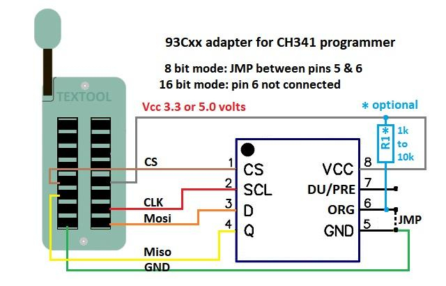

ECU EEPROM Pin out:
1 on Chip to 1 on Programmer
2 on Chip to 6 on Programmer
3 on Chip to 5 on Programmer
4 on Chip to 2 on Programmer
5 on Chip to 4 on Programmer
6 UNhooked
7 UNhooked
8 on Chip to 8 on Programmer
Done. You now have successfully wired up your CH341A to read the ECU eeprom.

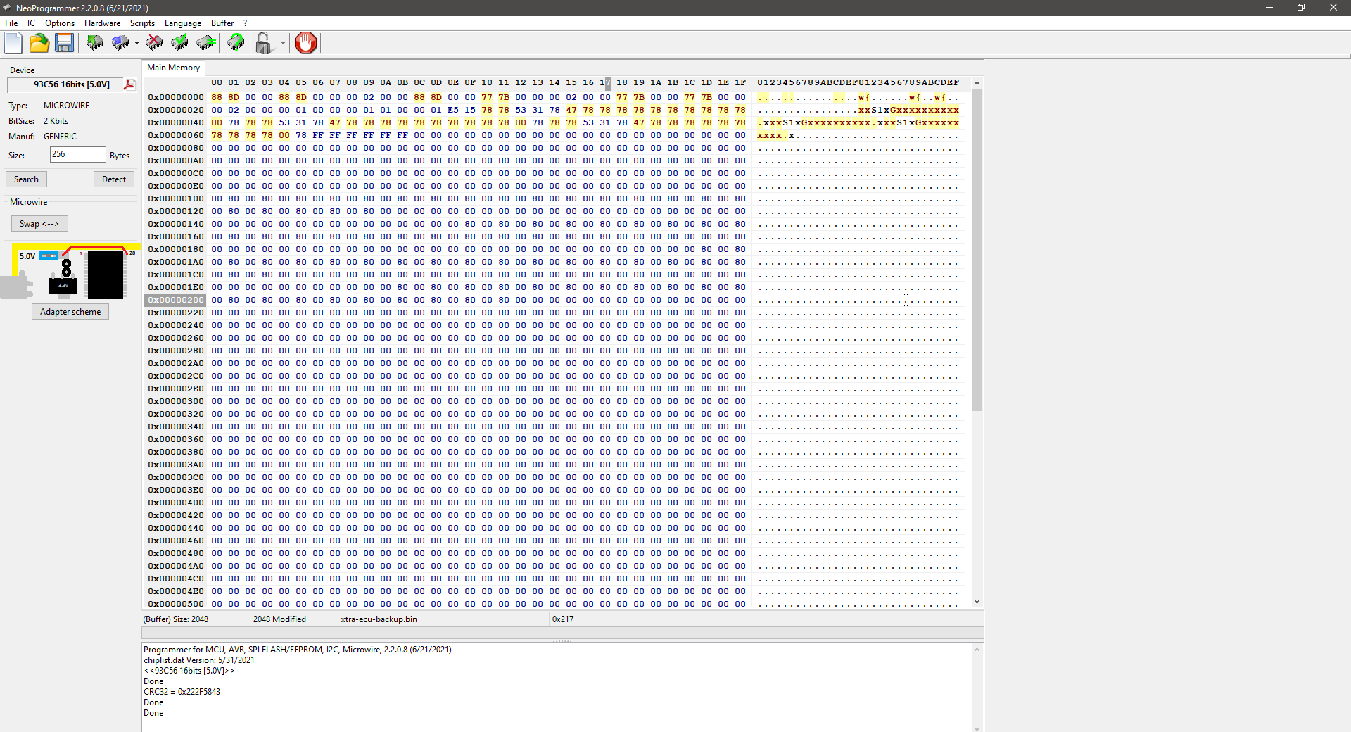

Now it's time to use the Neo-programmer to read the ECU or BIU.
The tool is super simple.
Open Neo-Programmer and make sure you have the chip connected, and the programmer is plugged into a working USB port. I had my speakers on so I could hear when the disconnect sound played from windows, this told me I had a good connection. To verify if you are connected hit the DETECT button on Neo-programmer. If you get options to choose a chip type you are connected to, if you get a blank box or error message in the logs you are not connected right. Keep trying and hitting detect as you position the clip. I had to hold my clip down while reading / writing to make sure it stayed on, it's a pain, and you’ll learn the best way to do it with trial and error.
Once you have a solid connection and you choose your chip ( this was broken down before )
Newer versions of Neo Programmer may ask for you to choose either 0,1,2 etc. due to multiple options. For the ECU it's under 0.
93c56r_16Bits 5v is the one for ECU / 24c16_8bits 3.3V is the BIU.
Okay, Time to hit the read button and see what happens!
Click the read button located at the top of Neo Programmer. If you get something other than all 0 or F you got it! The top 3 lines should contain Key Data, the next 3 are your VIN repeated 3x. And the last 6 or so lines are a checksum for the ecu and other data that I don’t have knowledge of. This is more so helping you save the entire file so you can clone it over to a donor ecu or store it in-case you have issues with the units.
Below is Neo-Programmer, I’m not going to go into a ton of data on how to use it, its really simple.
The Detect button is huge! Don't try clicking other stuff until you know you can detect and select the appropriate chip type, this way you know your connection is good. Read is the button next to the big floppy disk for “save”. Write is next to read.
Steps – Connect clip to the eeprom. Click detect and choose the appropriate chip you are working with.
Once selected click read and make sure it populates the data. SAVE IT, SAVE IT, SAVE IT.
If you delete this data, corrupt it etc., you will be buying a new ecu and new BIU from Subaru as I have no way to help you recover the key data or security id data. Once you have a good read and saved file, you can now move to the donor ecu follow the first 3 steps and read it, once you know it's readable, detected and working, use the folder icon to open your saved .hex or .bin file you created from your working ecu and then write it to the donor ecu / biu.
This should effectively move your immobilizer over and clone it to the donor, both ecu should be identical and now accept your keys / start the vehicle.

Some Additional Take Away Notes: IMPORTANT!!
When Viewing the data using NEOProgrammer, the data is “Backwards” This can be fixed, but you MUST “UN-fix” it prior to writing the data back to the EEPROM. The format is 100% important and if you *(Swap High and Low Bytes)* you must swap them back once you have made changes. This is under Buffer tab on the top panel.
You can verify that the data is skewed by looking at your vin#. If your vin# is reading out correctly you MUST swap the bytes before writing things back, if the vin# is slightly out of order then its in the correct format. The key data will not be valid without this being done!
Below is an explanation of how the Keys and Vin will appear with the Swap high and low bytes being pushed. I have changed the key data to FAKE data as well as the Vin# to a fake vin#.
This is for illustration purposes and is only for reference.
NOTE: Key data is repeated 3x, VIN# is repeated 3x. The other data represents the amount of keys programmed to the ECU.
You will see after the Vin# the ECU ends the code with FFFFF this signify s the run off of code.
The remaining code must NOT BE CHANGED. The bottom section is the HASH / CHECKSUM and is required for verification of the ecu integrity. Changing this will have negative consequences.
In the below Photos:
The vin#: in the reference photo are XX1SGXXXXXXXXXXX ( 16 Digit Vin ) a . for space and repeated 2 more times.
Keys: in the reference photo are 8D88, 7B77 – As well you can see it denotes there are 2 keys by the 00 02 repeated 3x.
This one is where the bytes are swapped to view the vin in the correct format, But is technically invalid:

Here is what I was able to read: the chip is A01A
https://www.dropbox.com/s/1i8gu8898ut43te/3.bin?dl=0

viachy wrote:
It seems like the readings of the trip computer are taken from the ECU, not the BIU, as there is no such data 09 8D 7B 00 in the BIU.
Try the option that inverts the numbers it has retrieved.
For some reason either that program or the hex editor I was using would render the info technically flipped and not give the right readout. If you do it on the ecu for say the vin # on the right panel the vin# should read out normally 3x If the data isn't correct you know it's displaying incorrectly and you need to switch the view to inverted.
Hope this helps

Here is how I connected the ECU:
6 UNhooked
7 UNhooked
I was very frustrated, as obviously I`m a noob and don`t know what I`m doing and I decided to give up eventually... assembled both boards together and put them back in the car. Fortunately I was not able to mess it up big time, as I was able to start the car normally.
I know I should have at least taken good pictures of the 2 boards for reference, but I was kind of emotional on my failure and now it`s too late..

Okay so I'm pretty sure I can see why it failed. You are using the 3v side of the programmer and not the 5v side. You should have your leads going into the bottom 4 rows of the usb connector furthest from the latch. If you look at the picture you attached where you sent a reading you did do it has the wrong side highlighted for the chip. The 5v eeprom only can be read from the bottom 4x4 connections. You also MUST do the mods i listed to the programmer at least the lifting of the resistor and the soldering of the wire between the two connections points I documented. Without such it will not power the 5v 16bit chip adequately and not work. As far as the outback ECU that seems to be normal. I am helping another member do a Forrester and the Ecu has 5 or so EEPROMS on the rear of the ECU. The immobilizer EEPROM would be segregated from any other components so you would be looking for the EEPROM by itself, as well if the usb reader has the orange light on saying RUN you have the chip on the EEPROM backwards and need to flip it around and attempt to connect again.
Please verify that you've done : The 2 mods to the reader, and you are using the correct section of the reader before we can move forward. Those are essential parts to have this work
I can 100% confirm this is working and the info is accurate as the other member just called and was able to read his test ecu without issue. I do not have the multiple variants of the ecu's so the EEPROM location for other years, makes, models WILL be different and the NEWER the ecu, the NEWER the EEPROM would be and would require you to pull the diagram for that EEPROM and wire the reader up accordingly to that chip type. I don't believe the EEPROM type changed until 2012ish or newer but I may be incorrect, would need others to inspect their ecus and share photos to pin point.
Refer to the below image for placement of wires.
download/file.php?id=39664&mode=view

One does not need to solder the programmer
Find the 5v and 3.3v on the long jumper string on the RHS (Looking at it fron the USB plug). These are usually pin 7 = 5v and pins 6 = 3.3 v. Ping 5 is GND. Place jumper on the pins 7+6. This puts 5v on the lines. This will allow programming. Verify with DVM.
