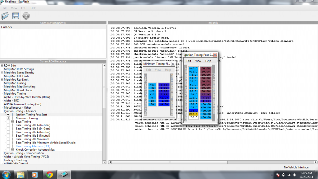

What is wrong here? Do I have to get the address' for A8DH200X because it inherits from that? Not really sure how that works...
Edit: Got the ignition timing to show correctly I believe. The coolant temp is not showing correctly... Here is my base and rom definitions

Your axis name is wrong - Y, not X - see the 32bitbase table.

I think I got it now. Sorry I am new to the whole definition stuff.... I'm a little confused by the Minimum Timing (Engine Speed) Values....?
