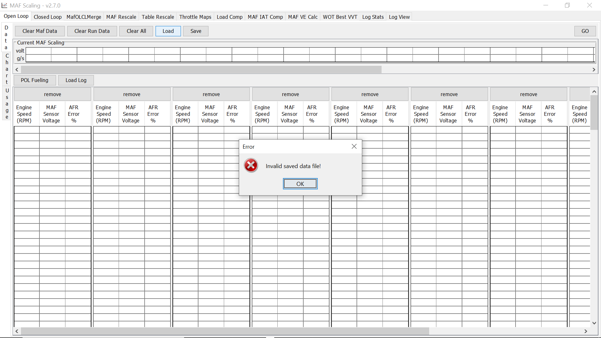

Hi! I don't understand.
Well, neither do I :) What file are you trying to load? The 'Load' button allows you to load file with saved data which you had saved before with 'Save' button. Now, if you try to load anything else you get an error.

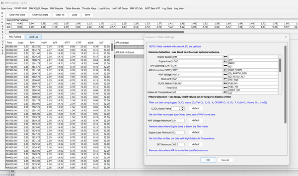

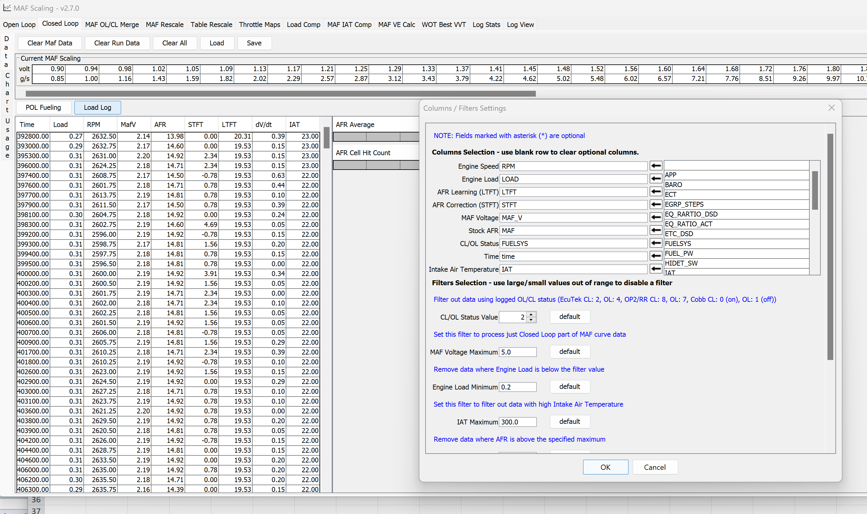

Would someone either link me to a post or help me to understand how one uses the Closed Loop tool? I come from miata community where some of our terminology differs. A few questions, if one would..
1: What is the purpose of including the POL Fueling table? If one is to lock their car into closed loop should the CL Fueling table be used in place of Primary Open Loop?
2: What is the meaning of Stock AFR within the 'Columns / Filter Settings' menu? Is this desired AFR / eq?
I suppose my biggest hurdle at this point is that when clicking 'Go', nothing happens. Attached is the log.
File comment: NC2 Miata FTCL
log0008.csv [1.57 MiB]
Downloaded 74 times
1. It's optional, POL table X/Y-Axis are used to display "AFR Average" and "AFR Cell Hit Count" tables which serve only informational purpose. You would just get a warning that those tables would not be generated. This info is on the Usage tab, was missing on the GitHub web, so I've added it.
2. Stock AFR - another words not Wideband O2.
If nothing is displayed that's usually some data or columns mapping or settings related issue. You could try to open maf_scaling.log to check for errors.
Your log file. I'm not sure I've properly mapped your columns - you should know the meaning of those columns better, particularly mapping to AFR (is it MAF, O2S12_FT?) and Closed/Open loop status (is it FUELSYS?) with value which would mean closed loop (is it 2)?
Anyways, using my MAF tables and arbitrary settings the data is calculated.
