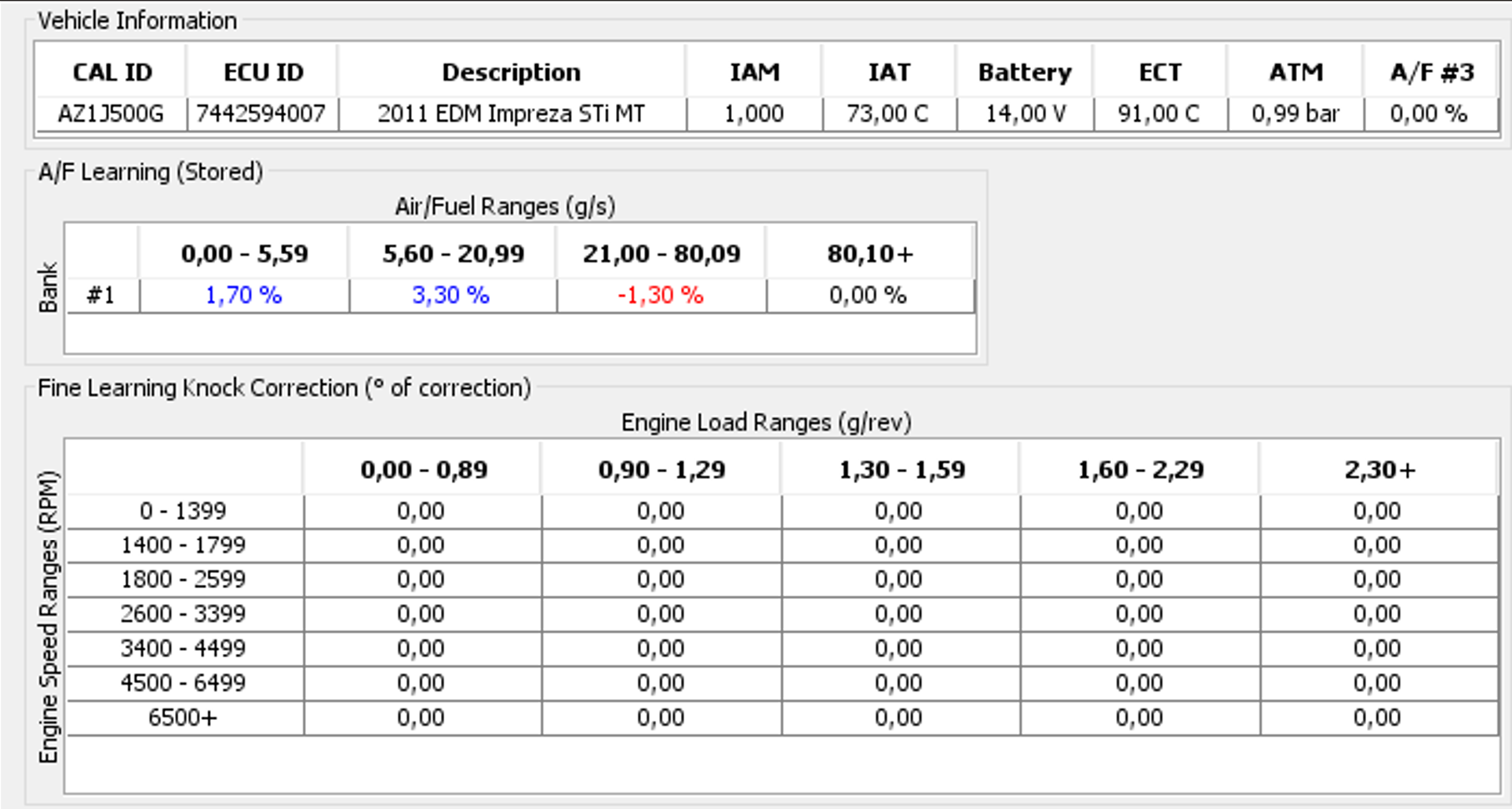

The car is running well, but when I'm cruising in the highway about 75 milles (120km/h) in 6th gear I have always high knock!
I tried a lot setups with the fuel, with timing and it is always the same, when I'm cuising the car in this situation has no torque!! and If I push the accelerator the knock starts
I don't know how to fix
I attach a picture and my actual rom
Thank u for your help!

Today I was doing more test and It is always the same, in 1-5gear no problem when I put 6th gear I have knock
I will play more with the tip-in and put the original values from stock and more fuel and reduce timing. But is strange because the car has no power in this situation
