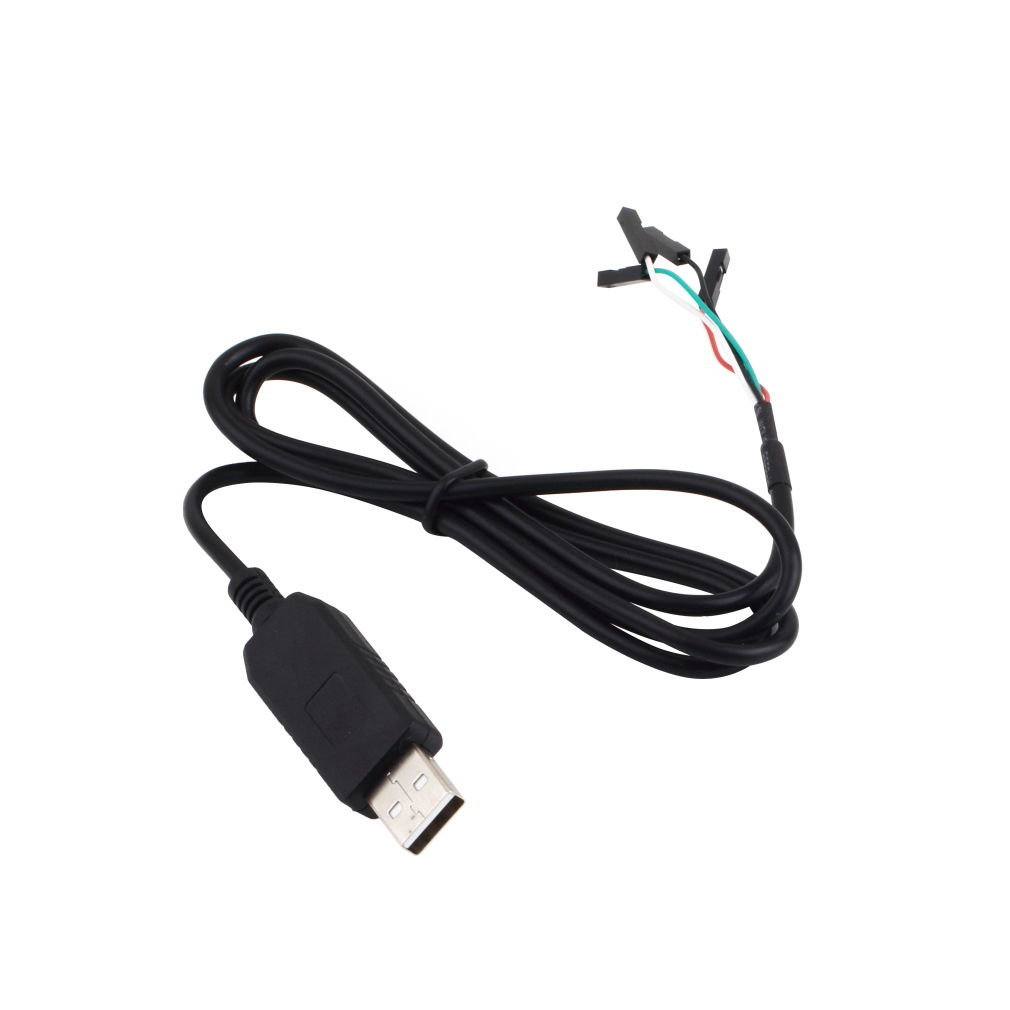

I just wanted to add my experience. Being a computer geek and having some components around (and being haunted by having to drive into work from a remote area in the morning) I had to make do with what I had.
And what I had was a 5 dollar USB to Serial cable from ebay that proved to be very convenient for the job:
I was able to solder normal header pins (the type that come with arduinos or any other standard breadboard) to the appropriate pins on my ECU (from an 08 wrx that was bricked while tuning). I was able to connect to the pins DIRECTLY so no further circuitry for the in circuit programming portion was needed. There's a resistor in the picture below but I'm fairly certain in the end I removed it.
13680396_1153583337995041_9007814499440630983_o.jpg [ 251.42 KiB | Viewed 8519 times ]
The only challenge was the watchdog timer. I didn't want to build a circuit so instead I made another hack and although it was a pain in the ass to get it to work just right, in the end I was able to successfully flash and unbrick the ECU.
I used a waveform generator program on the computer which ran a standard square wave into the audio output (but it was offset to 0v to +10v) so it was never going into the negative range.
I also used a pulldown resistor to ground on the ECU circuit that was also connected to the ground on the power supply.
The power supply was a large 12v brick style power supply (similar to monitor or laptop power supply).
Lastly i had to play with the output volume until it was just enough to keep the circuit online while writing the program.
I realize this is far from optimum, and far from the right way of doing this, but it's A way that worked for me in a pinch with much less circuitry or manual timers and so on.
